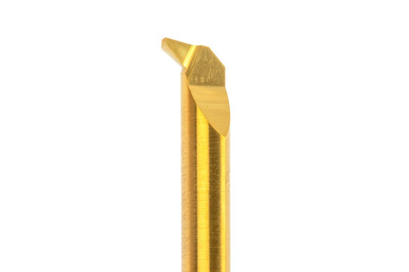

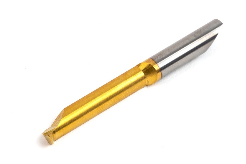

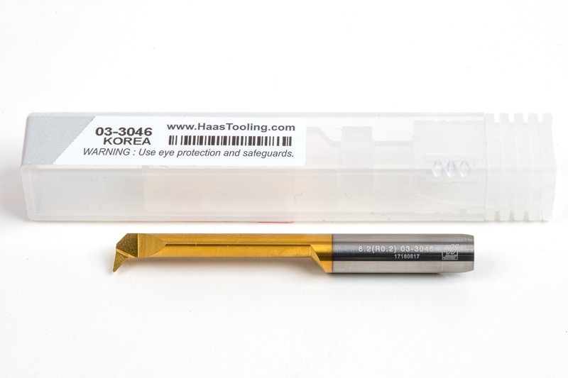

HMPB-6, 6mm Ø Carbide Internal (ID) Micro Profiling Tool, 6.2mm Min. Dia. x 30mm Head Length, Right-Hand
Part #: 03-3046
MICRO TURN, HMPB-6R6.2-3-20 TIN

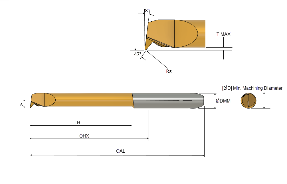

Type Tool
Toolpath Type ID Turn
Tool Orientation Internal
Hand of Tool Right
Insert Style HMPB - Profiling
Secondary Workpiece Material M - Stainless Steel, S - High Temp Alloys
Material Carbide
Coating TiN
Connection Size 6
[ØD] Min. Machining Diameter 0.244 in \ 6.2 mm
[ØDMM] Shank Diameter 0.236 in \ 6.0 mm
[LH] Head Length 1.181 in \ 30.0 mm
[OAL] Overall Length 2.283 in \ 58.0 mm
[OHX] Maximum Overhang 1.4 in \ 35.5 mm
[RE] Corner Radius 0.008 in \ 0.2 mm
[T-MAX] Maximum Depth 0.02 in \ 0.5 mm
[S] Center to Insert Dimension 0.116 in \ 2.95 mm
