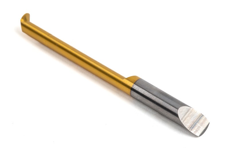

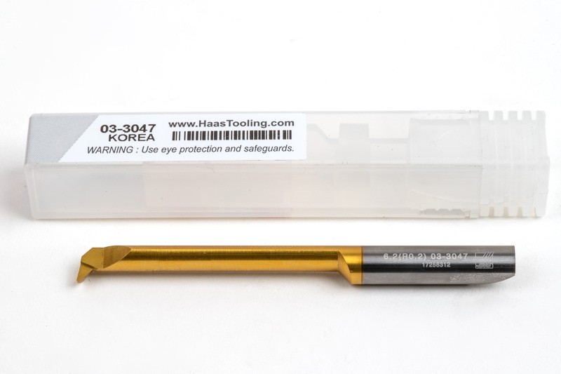

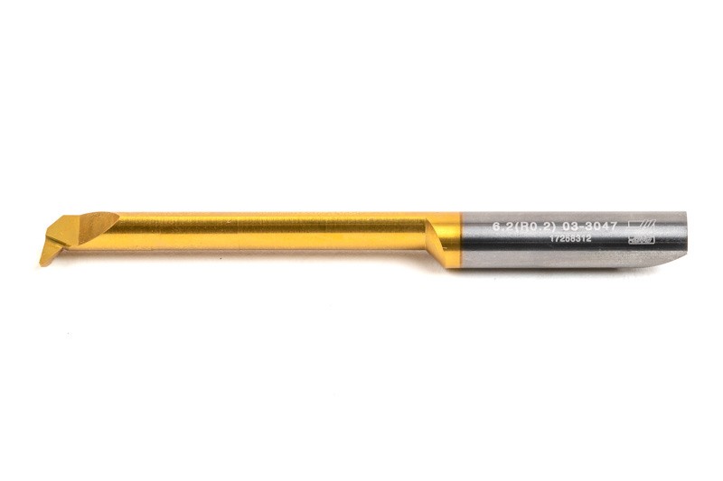

HMPB-6, 6mm Ø Carbide Internal (ID) Micro Profiling Tool, 6.2mm Min. Dia. x 40mm Head Length, Right-Hand
Part #: 03-3047

ISO MATERIAL CHART
Type Tool
Toolpath Type ID Turn
Tool Orientation Internal
Hand of Tool Right
Insert Style HMPB - Profiling
Secondary Workpiece Material S - High Temp Alloys, M - Stainless Steel
Material Carbide
Coating TiN
Connection Size 6
[ØD] Min. Machining Diameter 0.244 in \ 6.2 mm
[ØDMM] Shank Diameter 0.236 in \ 6.0 mm
[LH] Head Length 1.575 in \ 40.0 mm
[OAL] Overall Length 2.677 in \ 68.0 mm
[OHX] Maximum Overhang 1.79 in \ 45.5 mm
[RE] Corner Radius 0.008 in \ 0.2 mm
[T-MAX] Maximum Depth 0.02 in \ 0.5 mm
[S] Center to Insert Dimension 0.116 in \ 2.95 mm
