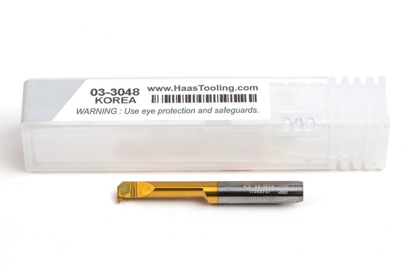

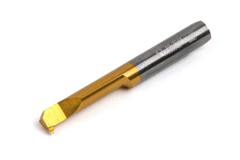

HMTH-4, 4mm Ø Carbide Internal (ID) Micro Partial Profile 60° Threading Tool, 0.5 - 0.7 Pitch, Right-Hand
Part #: 03-3048
MICRO TURN, HMTH-4R4.2-15-50 TIN
Price: 29.95 ( / unit)
Price: 623.95 ( / unit)
Price: 185.95 ( / unit)
Price: 24.95 ( / unit)
Price: 112.95 ( / unit)
Price: 261.95 ( / unit)
19.97
449.97
133.97
17.97
80.97
188.97
ISO MATERIAL CHART
Type Tool
Toolpath Type ID Thread
Tool Orientation Internal
Hand of Tool Right
Insert Style HMTH - Threading
Secondary Workpiece Material M - Stainless Steel, S - High Temp Alloys
Material Carbide
Coating TiN
Connection Size 4
Thread Type Partial Profile 60°
[TP] Thread Pitch 0.5 - 0.7 mm
[HA] Thread Height 0.018 in \ 0.45 mm
[ØD] Min. Machining Diameter 0.165 in \ 4.2 mm
[ØDMM] Shank Diameter 0.157 in \ 4.0 mm
[LH] Head Length 0.591 in \ 15.0 mm
[OAL] Overall Length 1.299 in \ 33.0 mm
[OHX] Maximum Overhang 0.71 in \ 18.0 mm
[RE] Corner Radius 0.002 in \ 0.06 mm
[S] Center to Insert Dimension 0.079 in \ 2.0 mm
[F] Dimension 0.011 in \ 0.28 mm
