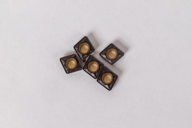

CCMT2152-HFP / CCMT060208-HFP, Carbide Turning Insert, 80° Rhombic, Grade HTK10 - Pack of 5
Part #: 02-0386
CCMT 2152-HFP HTK10
Price: 21.95 ( / unit)
Price: 310.95 ( / unit)
Price: 88.95 ( / unit)
Price: 11.95 ( / unit)
Price: 53.95 ( / unit)
Price: 125.95 ( / unit)
ISO Material Chart
Clamping Type S - Screw-On
Primary Workpiece Material K - Cast Iron
Secondary Workpiece Material P - Steel
Grade HTK10 - Light Interrupted
Material Carbide
Chipbreaker HFP - Finishing Positive
[IC] Inscribed Circle Diameter 0.25 in \ 6.35 mm
[D1] Insert Hole Size 0.11 in \ 2.8 mm
[L10] Cutting Edge Length 0.254 in \ 6.45 mm
[S] Insert Thickness 0.094 in \ 2.38 mm
