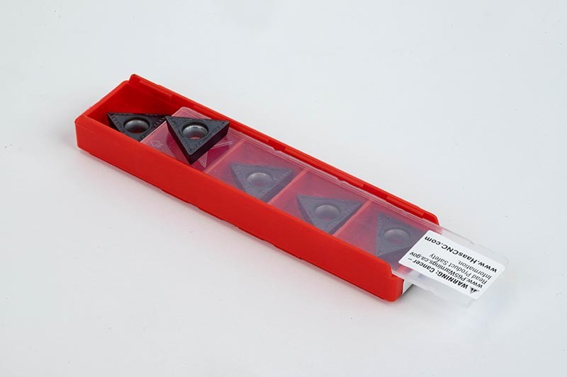

TCMT3251-HMU / TCMT16T304-HMU, Carbide Turning Insert, Triangle, Grade HTS25 - Pack of 5
Part #: 02-0731
TCMT 3251-HMU HTS25
Price: 24.95 ( / unit)
Price: 348.95 ( / unit)
Price: 103.95 ( / unit)
Price: 13.95 ( / unit)
Price: 62.95 ( / unit)
Price: 146.95 ( / unit)
ISO MATERIAL CHART
Clamping Type S - Screw-On
Insert Style T Style - Triangle
Primary Workpiece Material S - High Temp Alloys, M - Stainless Steel
Secondary Workpiece Material K - Cast Iron, P - Steel
Grade HTS25 - Medium Interrupted
Material Carbide
Chipbreaker HMU - Medium Universal
[D1] Insert Hole Size 0.173 in \ 4.4 mm
[L10] Cutting Edge Length 0.65 in \ 16.5 mm
[S] Insert Thickness 0.156 in \ 3.97 mm
[RE] Corner Radius 0.0157 in \ 0.4 mm
Country of Origin India
