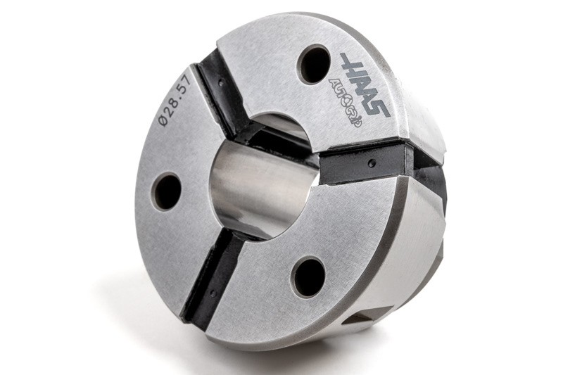

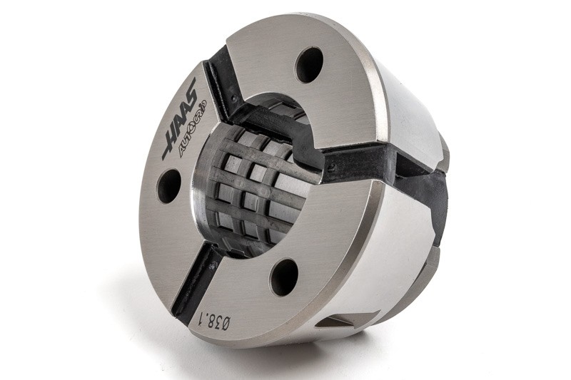

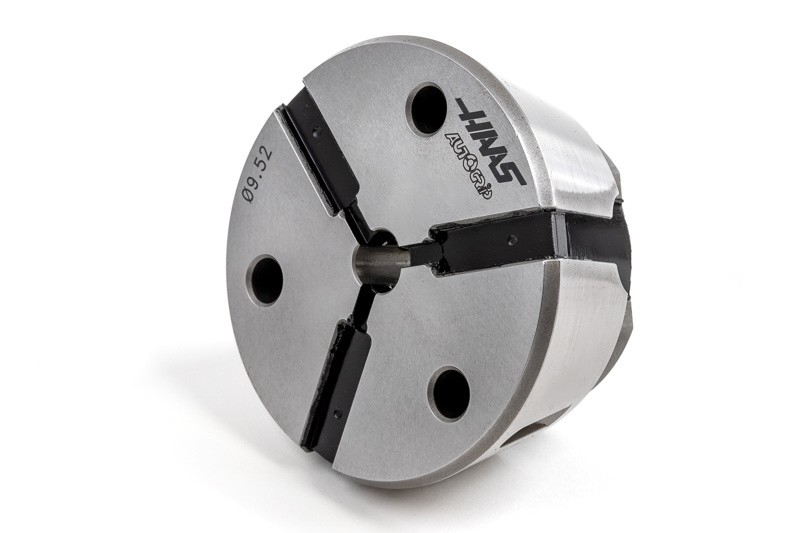

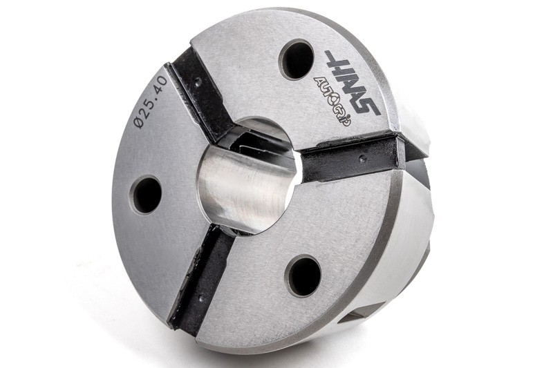

Reduce your lathe set-up times with this Haas quick-change collet chuck. Collets are changed in seconds, using a handheld collet changing tool (not included), making the changeover from one size material to another fast and easy. This pull-back style A2-5 collet chuck is compatible with Haas ST-10 lathes. Accepts a wide range of quick-change collets, in smooth and serrated styles (not included).
Haas Collet Chuck 42
____________________________
  • Pull back collet chuck
  • Compatible with Haas ST-10 lathes, including long-bed versions and Y-axis
  • Collet changes in seconds (requires handheld collet changing tool)
  • High clamping accuracy and rigidity
  • Sealed design for long life and minimal maintenance
  • Uses rubber grip collets for better grip and larger gripping range

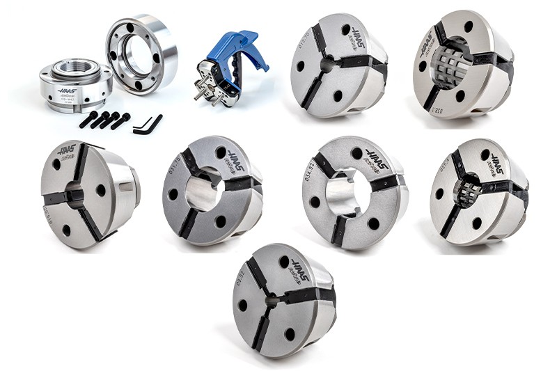

HQCB-42, Pull Back Collet Chuck Metric Kit for A2-5 Spindle Nose, M55x2.0 Drawbar Nut, 10mm-41mm Quick Change Collets
Part #: 08-2053
RETAIL PRICE:
HQCB-42, Pull Back Collet Chuck Inch Kit for A2-5 Spindle Nose, M55x2.0 Drawbar Nut, 3/8"-1-1/2" Quick Change Collets
Part #: 08-2059
RETAIL PRICE:

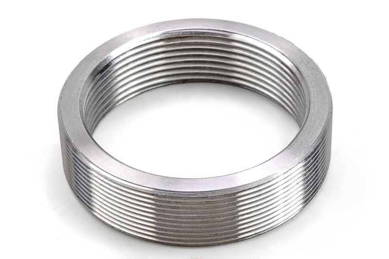

Dead Length Drawbar Nut for A2-5 Spindle Nose, M55x2.0 Thread Size
Part #: 06-0262
RETAIL PRICE:
Pull Back Drawbar Nut for A2-5 Spindle Nose, M55x2.0 Thread Size
Part #: 06-0267
RETAIL PRICE:
