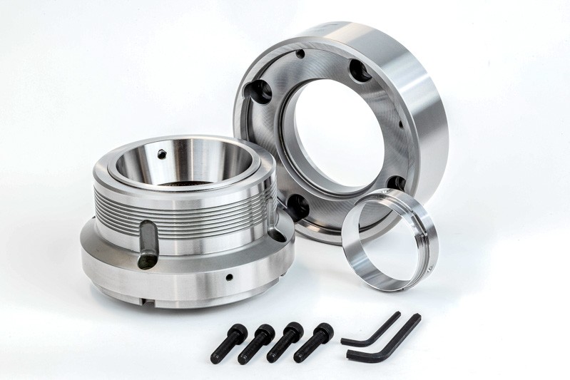

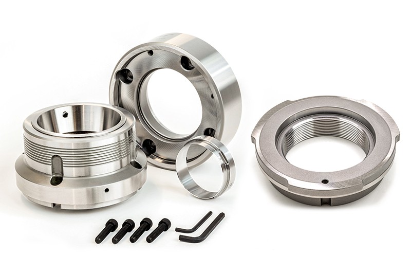

Reduce your lathe set-up times with this Haas quick-change collet chuck. Collets are changed in seconds, using a handheld collet changing tool (not included), making the changeover from one size material to another fast and easy. This pull-back style A2-6 collet chuck is compatible with older Haas ST-20 lathes .Accepts a wide range of quick-change collets, in smooth and serrated styles (not included).
Haas Collet Chuck 65
____________________________
  • Pull back collet chuck
  • Compatible with older Haas ST-20 lathes
  • Collet changes in seconds (requires handheld collet changing tool)
  • High clamping accuracy and rigidity
  • Sealed design for long life and minimal maintenance
  • Uses rubber grip collets for better grip and larger gripping range

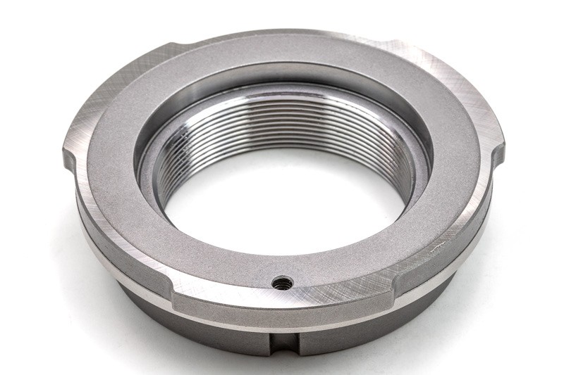

*VERIFY YOUR DRAWTUBE THREAD SIZE*
This collet chuck will only fit on older Haas ST-20 Lathes that feature an M60 thread. Please refer to the layout drawing of your machine to verify the drawtube thread on your machine to ensure an accurate fit.
