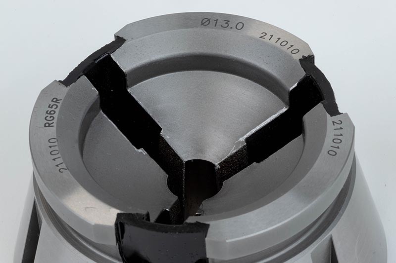

HRG-65R, 13mm Smooth Round Quick-Change Collet
Part #: 04-0314
LATHE COLLET, RG-65R-13
Price: 283.95 ( / unit)
Price: 6748.95 ( / unit)
Price: 2008.95 ( / unit)
Price: 269.95 ( / unit)
Price: 1214.95 ( / unit)
Price: 2834.95 ( / unit)
255.97
5074.97
1510.97
202.97
913.97
2131.97

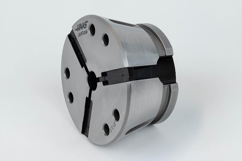

This quick-change rubber grip collet for the Haas HRG-65 collet chuck has a 13mm (0.512") bore diameter, with a ± 0.5mm (0.02") grip range. Smooth bore design for use with round bar stock.
Type Smooth Round
Collet Series HRG-65R
[ØD] Bore Diameter 13.0 mm
[ØBD] Body Diameter 99.5 mm
[OAL] Overall Length 53.0 mm
Maximum Collet Capacity 13.5 mm
Minimum Collet Capacity 12.5 mm
Weight 4.0 lbs \ 1.8 kg
Country of Origin Taiwan
