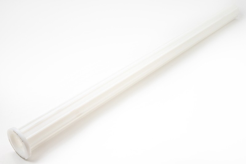

Haas 42" Extruded Spindle Liner, 2.0" Bore Diameter x 2.5" External Diameter, for Round Bar Stock
Part #: 05-0605
LINER 2 X 2.5 X 48"​
Price: 314.95 ( / unit)

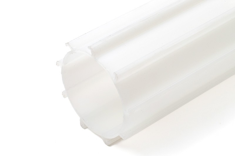

Haas spindle liners provide extra stability to bar stock during turning operations. Made from durable extruded high-density polyethylene, these spindle liners are an easy and inexpensive tool to utilize around the workshop. With a 2.0 in \ 2" internal bore and a 2.5 in \ 2-1/2" interference fit external diameter, these spindle liners are engineered to decrease vibration and maximize workflow with the use of the Haas Bar Feeder.
Type Liner
Machine Models ST-20Y, ST-20, ST-15Y, ST-15
Nominal Bore Diameter 2.0 in \ 2"
Nominal External Diameter 2.5 in \ 2-1/2"
[ØD] Bore Diameter 2.020 +0.010/-0.000 in
[ØED] External Diameter 2.565 ±0.010 in
[ØA] Head Diameter 3.3 in \ 3.3"
[BL] Body Length 42.0 in \ 42"
[OAL] Overall Length 42.38 in \ 42-3/8"
Weight 1.4 lbs \ 0.6 kg
Country of Origin USA
