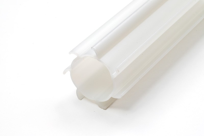

Haas spindle liners provide extra stability to bar stock during turning operations. Made from durable extruded high-density polyethylene, these spindle liners are an easy and inexpensive tool to utilize around the workshop. With a 30mm internal bore and a 45mm interference fit external diameter, these spindle liners are engineered to decrease vibration and maximize workflow with the use of the Haas Bar Feeder. This extended 1.32m extruded spindle liner is designed to with our Haas Extended Spindle Liner System, 44 mm - Metic.
  ** 1.32m spindle liners are to be used with Haas Extended Spindle Liner System, 44 mm - Metric. (93-1000845) **
Type Liner
Machine Models ST-10Y, ST-10
Nominal Bore Diameter 30.0 mm
Nominal External Diameter 45.0 mm
[ØD] Bore Diameter 30.38 +0.25 / -0.00 mm
[ØED] External Diameter 46.1 ±0.254 mm
[ØA] Head Diameter 58.9 mm
[BL] Body Length 1320.8 mm
[OAL] Overall Length 1330.5 mm
Weight 1.4 lbs \ 0.6 kg
