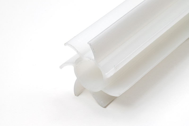

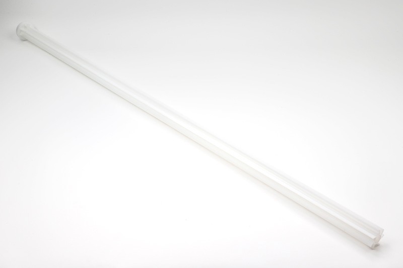

Haas 52" Extruded Spindle Liner, 0.75" Bore Diameter x 1.75" External Diameter, for Round Bar Stock
Part #: 05-0726
LINER 3/4 X 1.8 X 60"
Price: 159.95 ( / unit)
Haas spindle liners provide extra stability to bar stock during turning operations. Made from durable extruded high-density polyethylene, these spindle liners are an easy and inexpensive tool to utilize around the workshop. With a 0.75 in \ 3/4" internal bore and a 1.75 in \ 1-3/4" interference fit external diameter, these spindle liners are engineered to decrease vibration and maximize workflow with the use of the Haas Bar Feeder. This extended 52 in \ 52" extruded spindle liner is designed to with our Haas Extended Spindle Liner System, 1.75" - Inch.
  ** 52.0 in \ 52" spindle liners are to be used with Haas Extended Spindle Liner System, 1.75" - Inch. (93-1000844) **
Type Liner
Machine Models ST-10Y, ST-10
Nominal Bore Diameter 0.75 in \ 3/4"
Nominal External Diameter 1.75 in \ 1-3/4"
[ØD] Bore Diameter 0.765 +0.010/-0.000 in
[ØED] External Diameter 1.815 ±0.010 in
[ØA] Head Diameter 2.32 in \ 2.32"
[BL] Body Length 52.0 in \ 52"
[OAL] Overall Length 52.38 in \ 52-3/8"
Weight 1.4 lbs \ 0.6 kg
Country of Origin USA
