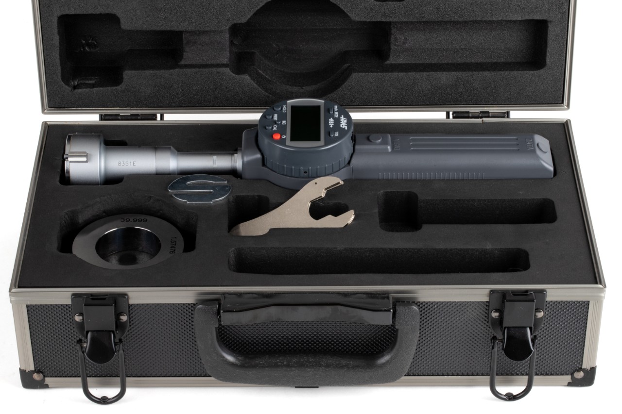

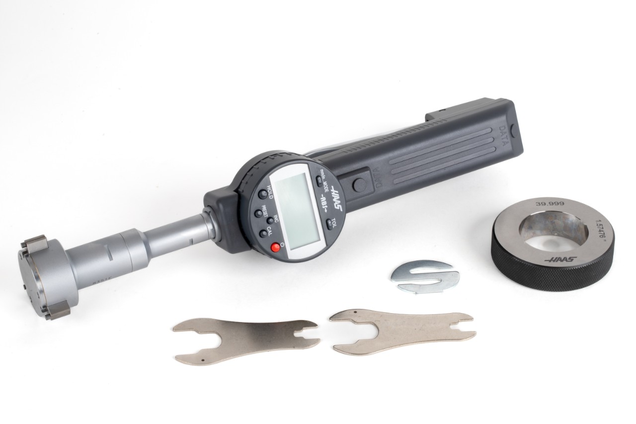

Haas digital snap bore gauges are designed for accurately measuring bore diameters.  This bore gauge features three carbide contact points for a long service life, 330° display rotation, ergonomic handle for quick engagement and disengagement, and a calibration ring for zero-point adjustment.

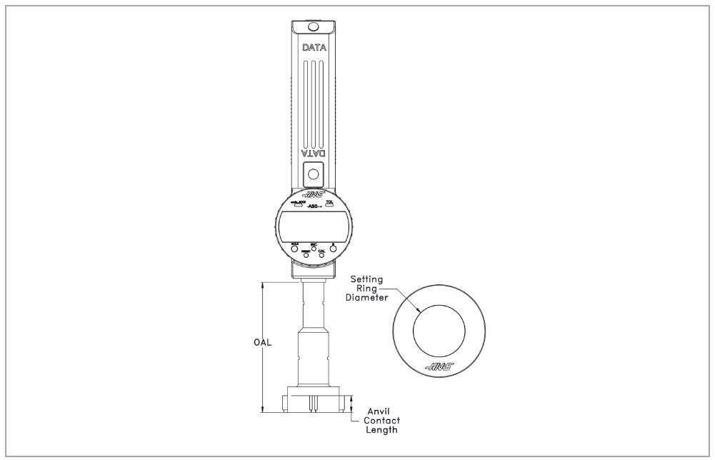

Type Digital Bore Gauge
Resolution 0.00005 in \ 0.001 mm
Accuracy ± 0.0003 in \ ± 0.008 mm
Range 1.6-2.0 in \ 40.0-50.0 mm
Depth Range 4.1 in \ 105.0 mm
[OAL] Overall Length 4.1 in \ 105.0 mm
Anvil Material Carbide
Anvil Contact Length 0.55 in \ 14.0 mm
Setting Ring Diameter 1.5748 in \ 40.0 mm
Setting Ring Diameter Accuracy ± 0.0001 in \ ± 0.003 mm
