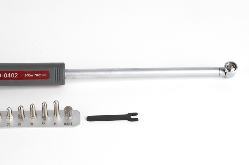

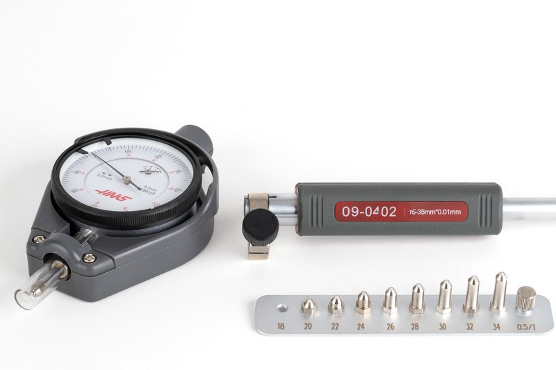

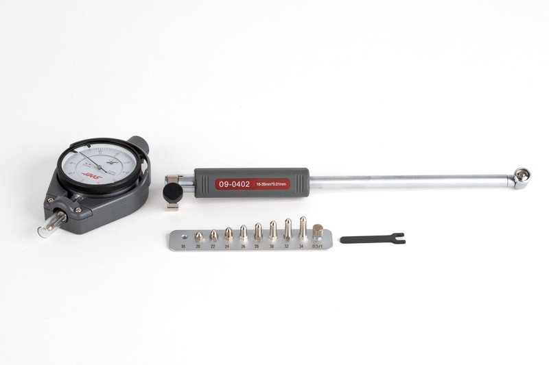

This Haas dial bore gauge has a measuring range of 18.0 - 35.0 mm. It features a 0.01 mm dial graduation, a 150.0 mm depth reach, and a set of 9 ceramic anvils plus spacers to cover the entire measuring range. The continous dial numbering makes this model convienient for taking direct measurements of bores.
  • Technical Documents
  • Operator's Manual
Type Standard Dial
Dial Reading 0-100
Dial Diameter 58.0 mm
Dial Type Continuous
Graduation 0.01 mm
Accuracy ± 0.015 mm
Range 18.0 - 35.0 mm
Range Per Revolution 1.0 mm
Depth Range 150.0 mm
Number of Anvils 9
Anvil Sizes 18mm, 20mm, 22mm, 24mm, 26mm,
Anvil Material Ceramic
Bearing Type Jeweled
Fulcrum Material GCr15
Hysteresis 0.003 mm
Repeatability 0.003 mm
Conformance Standard CNAS
Weight 2.6 lbs \ 1.2 kg
