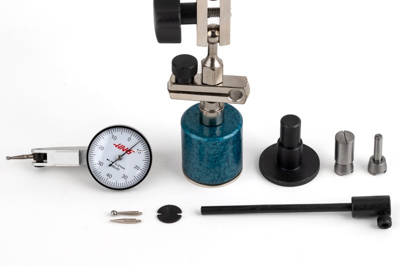

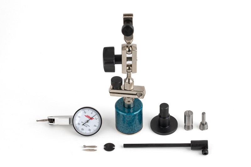

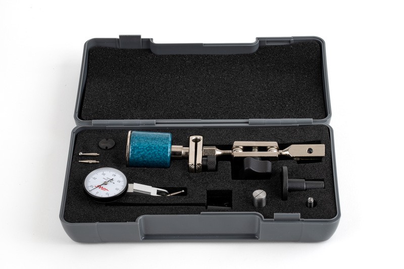

This convienient set comes with a Haas indicator plus its accessories and a mini mag-base. The indicator has graduations of 0.01mm with 0-40-0 dial numbering and a range of 0.8 mm. Comes with 4.0 & 8.0 mm accessory stems and a set of 1/2/3mm stylus tips. Miniature mag-base includes fine-adjust mechanism and an extension holder rod.
Note: The coin washer must be removed from the magnetic base to achieve full magnetic force.
