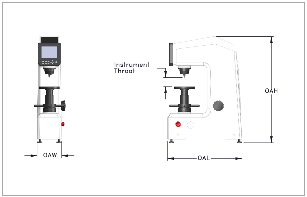

Maximum Specimen Height
6.890 in \ 175.0 mm
Maximum Specimen Weight
66.139 lbs \ 30.0 kg
Instrument Throat
6.496 in \ 165.0 mm
[OAL] Overall Length
21.496 in \ 546.0 mm
[OAW] Overall Width
7.165 in \ 182.0 mm
[OAH] Overall Height
29.724 in \ 755.0 mm
Net Weight
198.416 lbs \ 90.0 kg
Gross Weight
216.10 lbs \ 98.0 kg
Shipping Dimensions Inches (L x W x H)
 24.409 x 18.110 x 34.252 in
Shipping Dimensions mm (L x W x H)
620 x 460 x 870 mm
