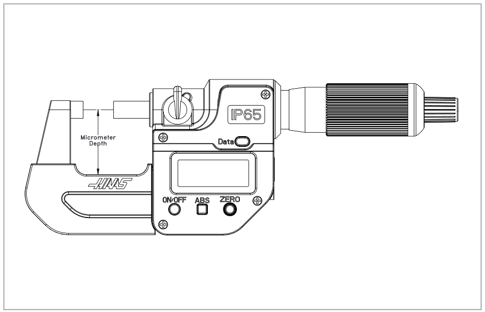

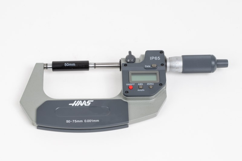

Outside micrometers are used in various applications and are most commonly used when measuring outside diameters or thicknesses of parts and features. This micrometer features a digital display, metric thimble graduations, carbide tipped anvils, stainless steel spindle, and an IP65 rating for dust and liquid resistance.

Type Digital Outside Micrometer
Thimble System of Measurement Metric - ISO
Range 2.0 - 3.0 in \ 50.0 - 75.0 mm
Resolution 0.00005 in \ 0.001 mm
Graduation 0.01 mm
Thimble Type Ratchet Thimble
Accuracy ± 0.004 mm
Anvil Material Carbide
Spindle Material Stainless Steel
Micrometer Depth 44.0 mm
Standard DIN 863
Conformance Standard CNAS
IP Code IP65
Includes Battery Yes
Power Supply CR2450
Weight 2.2 lbs \ 1.0 kg
