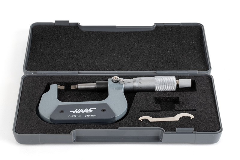

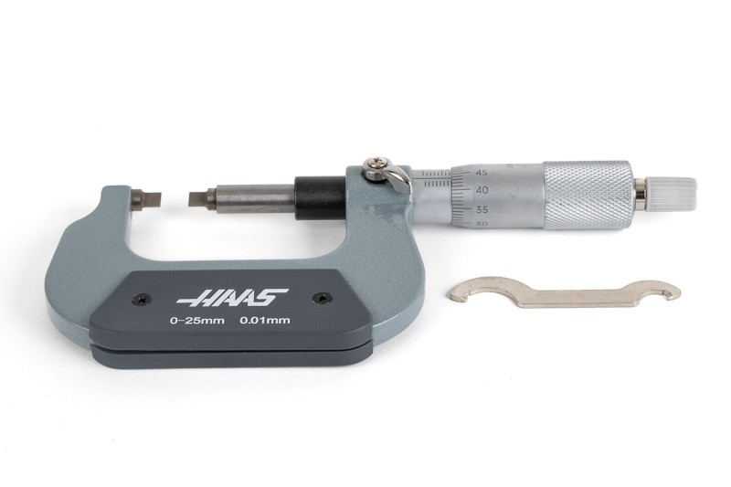

Blade Micrometers are key for measuring hard-to-reach features such as notches or grooves. This micrometer features a metric thimble graduation, ball bearing steel anvils, and a stainless steel, non-rotating spindle.
  • Operator's Manual
Micrometer Videos
Reading a Metric Vernier Micrometer
Reading an Inch Vernier Micrometer
Specialized OD
Vernier Micrometer
Quality

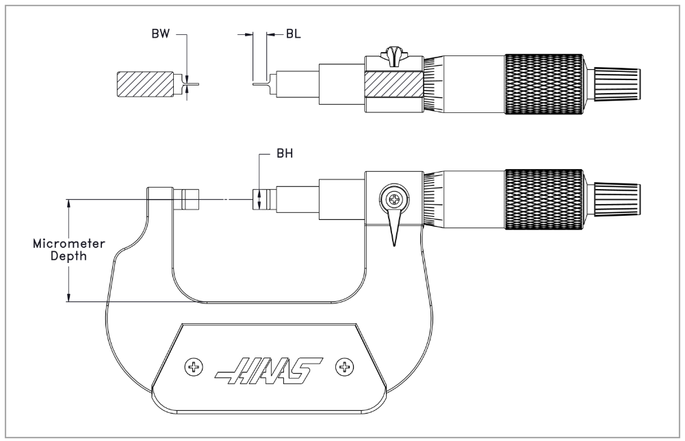

Type Blade Micrometer
Thimble System of Measurement Metric - ISO
Range 0 - 25.0 mm
Graduation 0.01 mm
Thimble Type Ratchet Thimble
Spindle Type Non-Rotating
Accuracy ± 0.004 mm
Anvil Material Stainless Steel
Spindle Material Stainless Steel
Micrometer Depth 31.0 mm
[BH] Blade Height 6.0 mm
[BW] Blade Width 0.75 mm
[BL] Blade Length 6.5 mm
Standard DIN 863
Conformance Standard CNAS
Weight 1.2 lbs \ 0.6 kg
