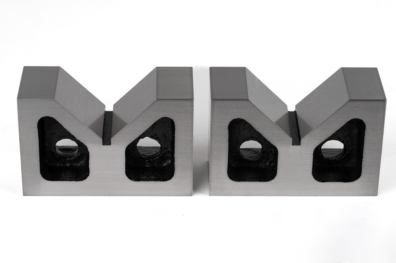

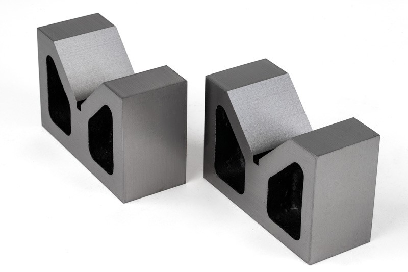

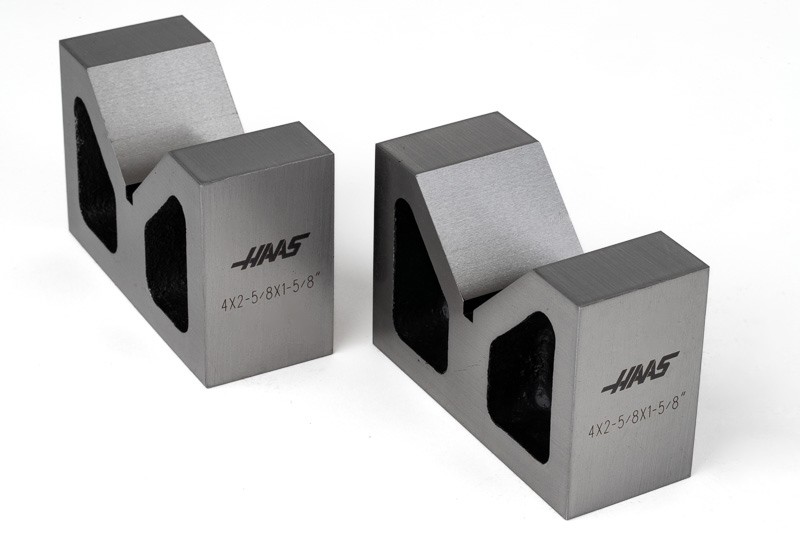

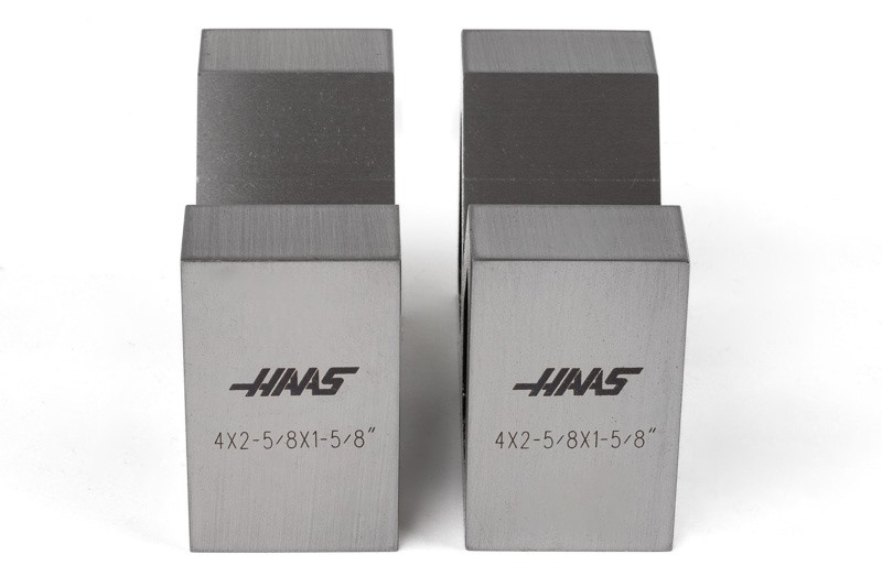

Cast Iron V-Block Pair, 4 x 2-5/8 x 1-5/8", 3" Ø Workpiece Capacity
Part #: 09-0645
V-BLOCK, 4 x 2-5/8 x 1-5/8"
Price: 37.95 ( / unit)
20.97
This Haas cast iron V-block set works great in general setup tasks and can accommodate a workpiece diameter of up to 2.4" (60mm). The outer faces are ground to 0.0012" (0.03mm) squareness/parallelism, and the V faces are ground to 0.0004" (0.01mm) flatness.
Type Cast Iron V-Block
[L] Length 1.625 in
[W] Width 4.0 in
[H] Height 2.625 in
V Groove Angle 90
V Width 2.248 in
V Depth 1.205 in
Maximum Workpiece Diameter 3.071 in
V Flatness 0.0004 in
Squareness 0.0012 in
Parallelism 0.0012 in
Material Cast Iron
Weight 6.6 lb \ 3.0 kg
