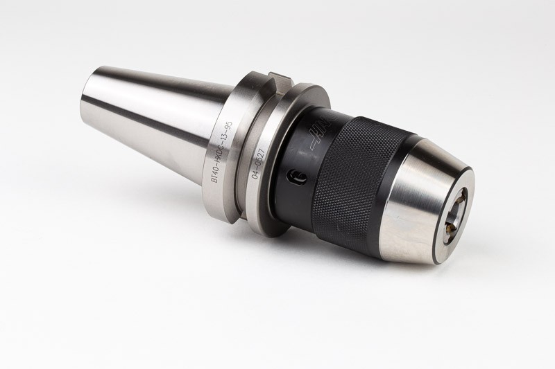

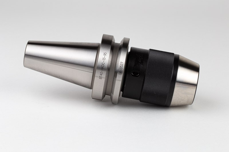

This BT40 NPU13 NC keyless drill chuck accepts a wide range of drill sizes (1mm to 13mm), and has a 95mm gage length. The drill chuck is versatile and easy to use, and is integrated with the toolholder into a single body for a more compact design. This chuck has a M16x2.0 pull stud/retention knob thread.
Note: Haas NC Keyless Drill Chucks requires use of spanner wrench (06-0385) in order to properly tighten chucks. Spanner wrench sold separately.
Taper BT40
[ØBD] Body Diameter 50.0 mm
[ØDCBN] Minimum Bore Diameter 1.0 mm
[ØDCBX] Maximum Bore Diameter 13.0 mm
[GL] Gage Length 95.0 mm
[LH] Head Length 68.0 mm
[OAL] Overall Length 160.4 mm
Concentricity 0.01 mm
Balanced to RPM 5000
Retention Knob Thread Size M16-2.0
Through Tool Coolant No
Spindle Drive Slots Yes
Weight 4.0 lbs \ 1.8 kg
