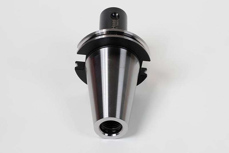

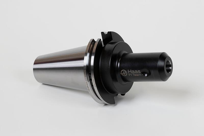

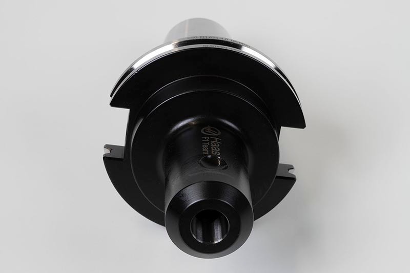

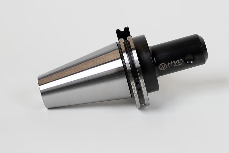

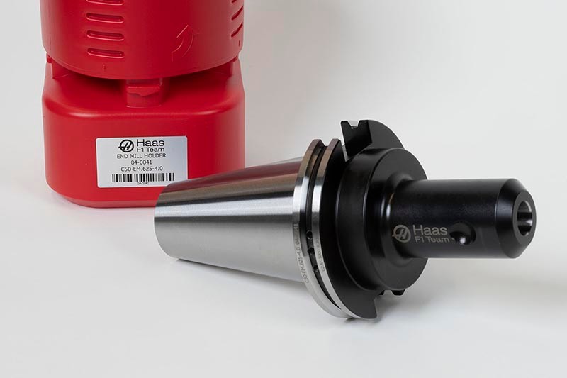

CT50 5/8" End Mill Holder x 4" Gage Length, TSC
Part #: 04-0041
CT50-EM-0.625-4.0
Price: 92.95 ( / unit)
74.97
This CAT50 end mill holder has a 0.625 in \ 5/8" bore diameter and a 4" gage length. It uses the Weldon flat standard with side-lock clamping for secure clamping of cutting tools. It is through-tool coolant (TSC) capable, with a 1"-8 pull stud/retention knob thread.
Taper CT50
[ØD] Bore Diameter 0.625 in \ 5/8"
[ØBD] Body Diameter 1.5 in
[ØBD2] Minimum Body Diameter 1.0 in
[GL] Gage Length 4.0 in
[BL] Body Length 3.25 in
[ØD2] Shoulder Diameter 2.75 in
[SH] Shoulder Height 0.63 in
[TP1_L] Thread Location 0.938 in
[TP1] Thread 1/2"-20
Concentricity 0.0002 in
Balanced to RPM 15000
Bore Tolerance H5
Retention Knob Thread Size 1"-8
Through Tool Coolant Yes
Spindle Drive Slots Yes
Weight 8.0 lbs \ 3.6 kg
