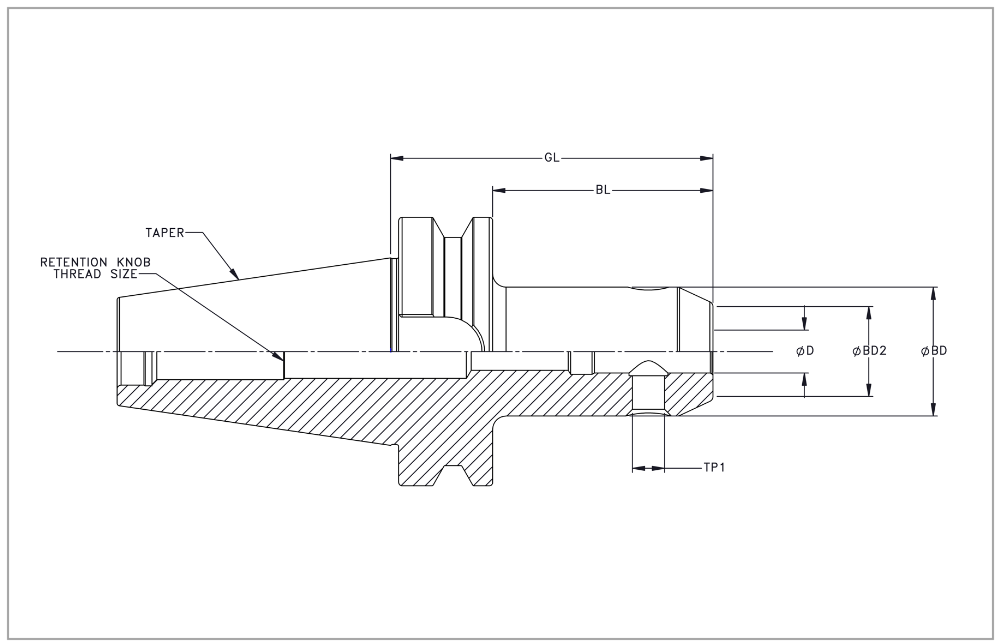

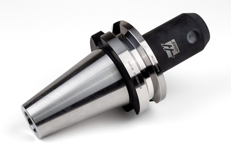

This BT50 end mill holder has a 16mm bore diameter and a 120mm gage length. It uses the Weldon flat standard with side-lock clamping for secure clamping of cutting tools. It is through-tool coolant (TSC) capable, with a M24x3.0 pull stud/retention knob thread.
Taper BT50
[ØD] Bore Diameter 16.0 mm
[ØBD] Body Diameter 48.0 mm
[ØBD2] Minimum Body Diameter 36.0 mm
[GL] Gage Length 120.0 mm
[BL] Body Length 82.0 mm
[TP1_L] Thread Location 24.0 mm
[TP1] Thread M14x2.0
Concentricity 0.005 mm
Balanced to RPM 15000
Bore Tolerance H5
Retention Knob Thread Size M24X3.0
Through Tool Coolant Yes
Spindle Drive Slots Yes
Weight 9.7 lbs \ 4.4 kg
