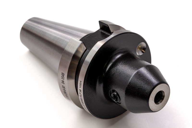

This BT30 end mill holder has a 10.0 mm bore diameter and a 50mm gage length. It uses the Weldon flat standard with side-lock clamping for secure clamping of cutting tools. It is through-tool coolant (TSC) capable, with a M12x1.75 pull stud/retention knob thread.
Taper BT30
[ØD] Bore Diameter 10.0 mm
[ØBD] Body Diameter 35.0 mm
[ØBD2] Minimum Body Diameter 25.0 mm
[GL] Gage Length 50.0 mm
[BL] Body Length 28.0 mm
[TP1] Thread M10x1.5
Concentricity 0.003 mm
Balanced to RPM 18000
Bore Tolerance H4
Retention Knob Thread Size M12X1.75
Through Tool Coolant Yes
Spindle Drive Slots Yes
Weight 1.3 lbs \ 0.6 kg
Country of Origin India
