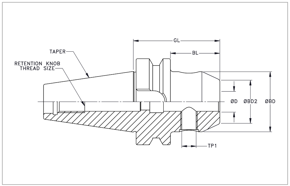

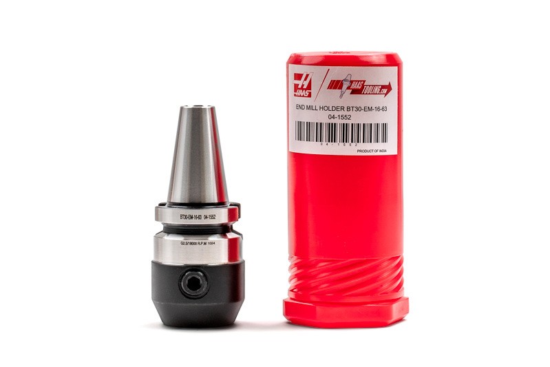

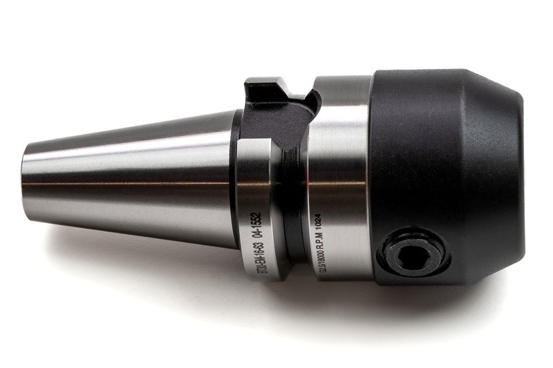

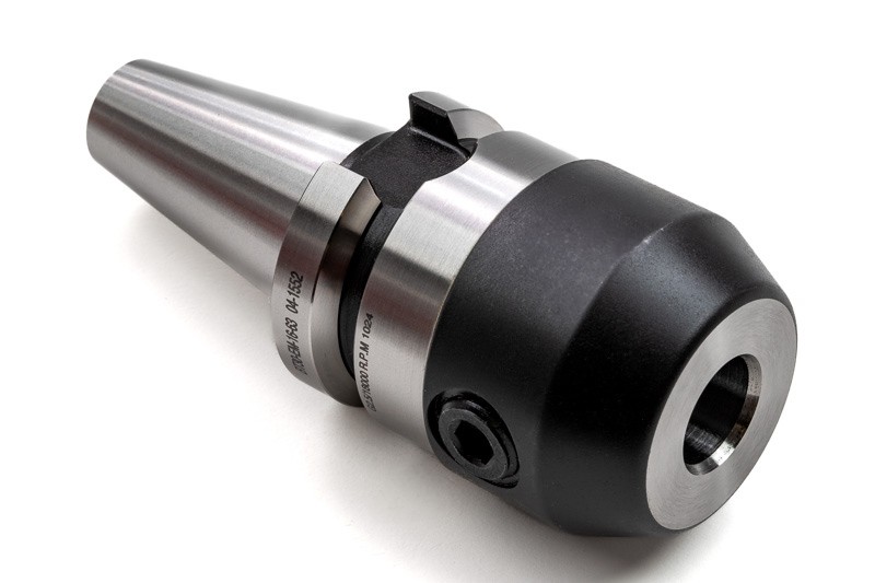

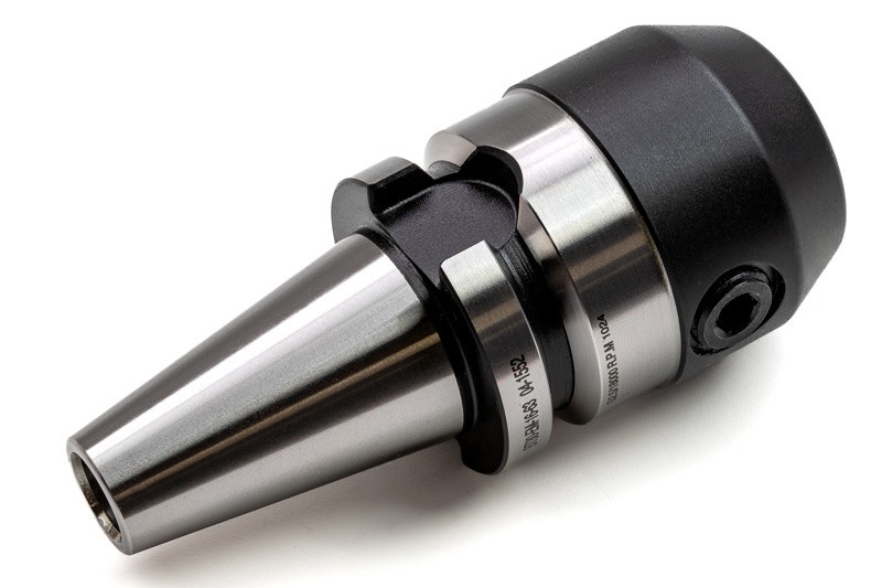

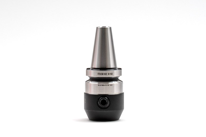

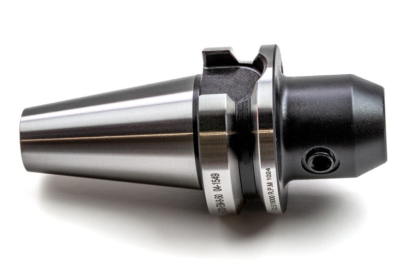

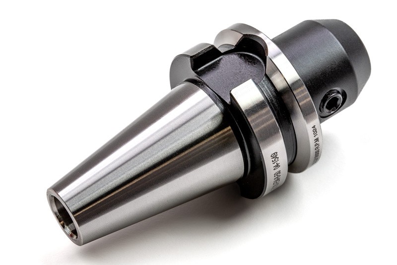

BT30 16mm End Mill Holder x 63mm Gage Length, TSC
Part #: 04-1552
BT30-EM-16-63
Price: 62.95 ( / unit)
This BT30 end mill holder has a 16.0 mm bore diameter and a 63mm gage length. It uses the Weldon flat standard with side-lock clamping for secure clamping of cutting tools. It is through-tool coolant (TSC) capable, with a M12x1.75 pull stud/retention knob thread.
Taper BT30
[ØD] Bore Diameter 16.0 mm
[ØBD] Body Diameter 48.0 mm
[ØBD2] Minimum Body Diameter 36.0 mm
[GL] Gage Length 63.0 mm
[BL] Body Length 41.0 mm
[TP1] Thread M14x2.0
Concentricity 0.003 mm
Balanced to RPM 18000
Bore Tolerance H4
Retention Knob Thread Size M12X1.75
Through Tool Coolant Yes
Spindle Drive Slots Yes
Weight 2.0 lbs \ 0.9 kg
