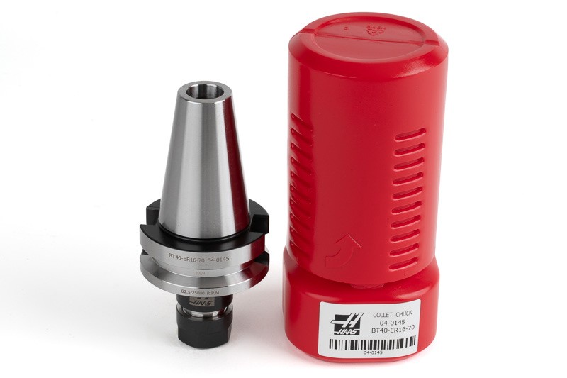

BT40 ER16 Collet Chuck x 70mm Gage Length, TSC
Part #: 04-0145
BT40-ER16-70
Customer Rating:
Price: $79.95 ( / unit)
Price: 1323.95 ( / unit)
Price: 393.95 ( / unit)
Price: 52.95 ( / unit)
Price: 238.95 ( / unit)
Price: 555.95 ( / unit)
$39.97
949.97
282.97
37.97
170.97
398.97

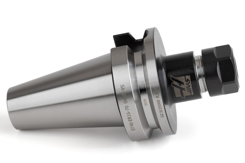

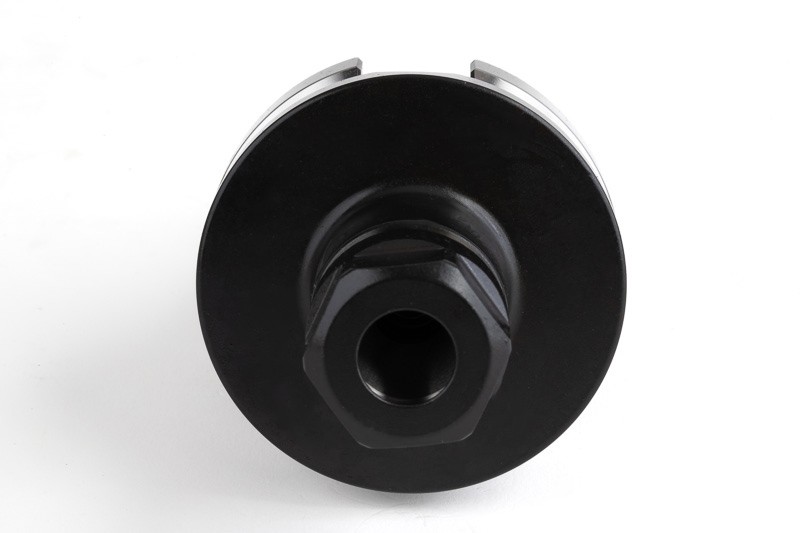

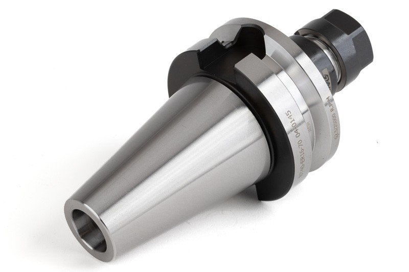

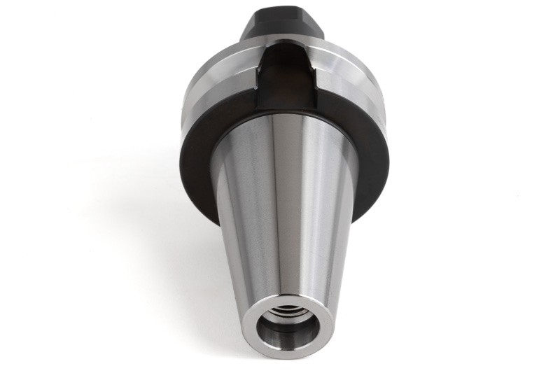

This BT40 ER16 collet chuck accepts a variety of ER16 collet styles, and has a 70mm gage length. The double-taper collet design provides high clamping force for round, smooth shank tools, and offers a wide gripping range with excellent TIR and balance. It is through-tool coolant (TSC) capable, with a M16x2.0 pull stud/retention knob thread.
$37.97 (Save 5%)
Taper BT40
Collet Series ER-16
[ØBD] Body Diameter 28.0 mm
[GL] Gage Length 70.0 mm
[BL] Body Length 43.0 mm
Concentricity 0.008 mm
Balanced to RPM 25,000
Retention Knob Thread Size M16X2.0
Through Tool Coolant Yes
Spindle Drive Slots Yes
Weight 2.2 lbs \ 1.0 kg
