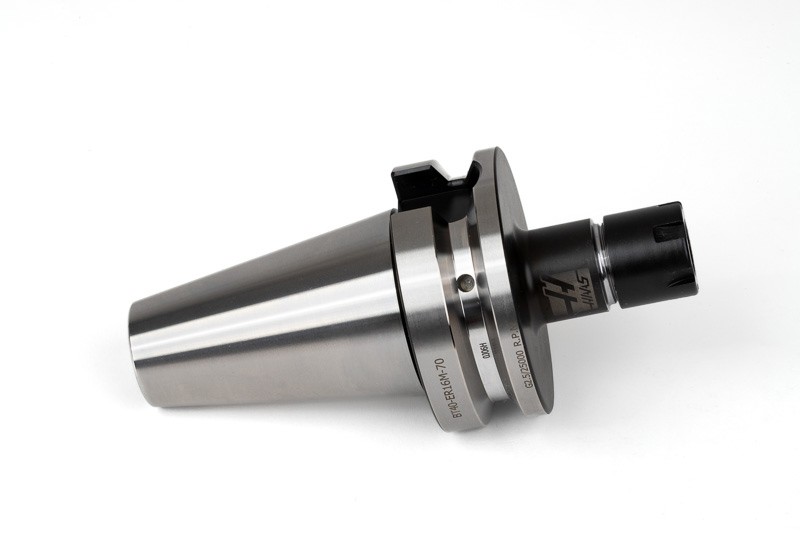

This BT40 ER16 collet chuck accepts a variety of ER16 collet styles, and has a 70mm gage length. The double-taper collet design provides high clamping force for round, smooth shank tools, and offers a wide gripping range with excellent TIR and balance. It is through-tool coolant (TSC) capable, with a M16x2.0 pull stud/retention knob thread.
Taper BT40
Collet Series ER-16
[ØBD] Body Diameter 22.0 mm
[GL] Gage Length 70.0 mm
[BL] Body Length 43.0 mm
Concentricity 0.005 mm
Balanced to RPM 25000
Retention Knob Thread Size M16X2.0
Through Tool Coolant Yes
Spindle Drive Slots Yes
Weight 2.2 lbs \ 1.0 kg
