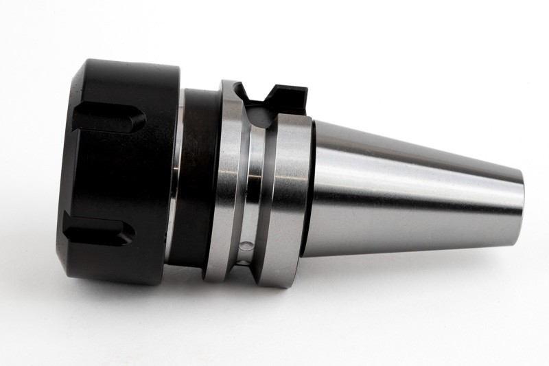

This BT30 ER32 collet chuck accepts a variety of ER32 collet styles, and has a 60mm gage length. The double-taper collet design provides high clamping force for round, smooth shank tools, and offers a wide gripping range with excellent TIR and balance. It is through-tool coolant (TSC) capable, with a M12x1.75 pull stud/retention knob thread.
Taper BT30
Collet Series ER-32

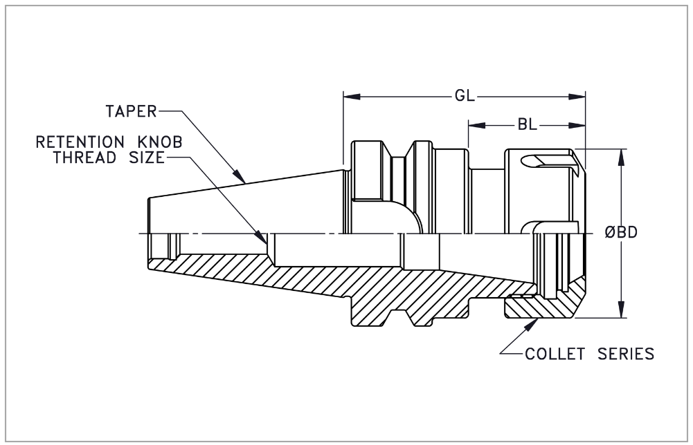

[ØBD] Body Diameter 50.0 mm
[GL] Gage Length 60.0 mm
[BL] Body Length 38.0 mm
Concentricity 0.005 mm
Balanced to RPM 25000
Retention Knob Thread Size M12X1.75
Through Tool Coolant Yes
Spindle Drive Slots Yes
Weight 1.3 lbs \ 0.6 kg
