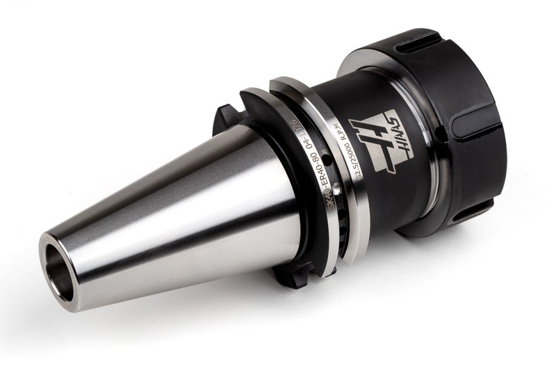

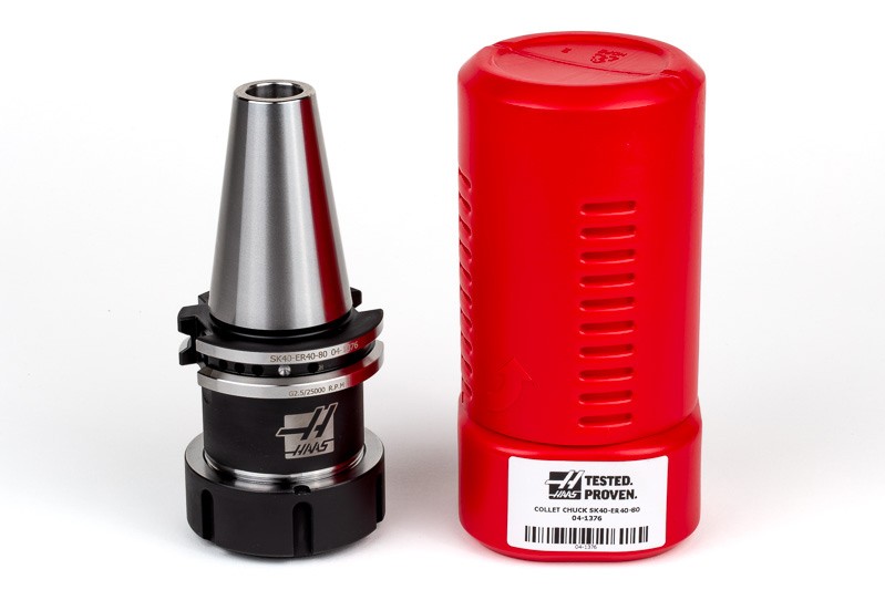

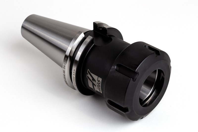

This SK40 \ DIN 69871 ER40 collet chuck accepts a variety of ER40 collet styles, and has a 80mm gage length. The double-taper collet design provides high clamping force for round, smooth shank tools, and offers a wide gripping range with excellent TIR and balance. It is through-tool coolant (TSC) capable, with a M16x2.0 pull stud/retention knob thread.

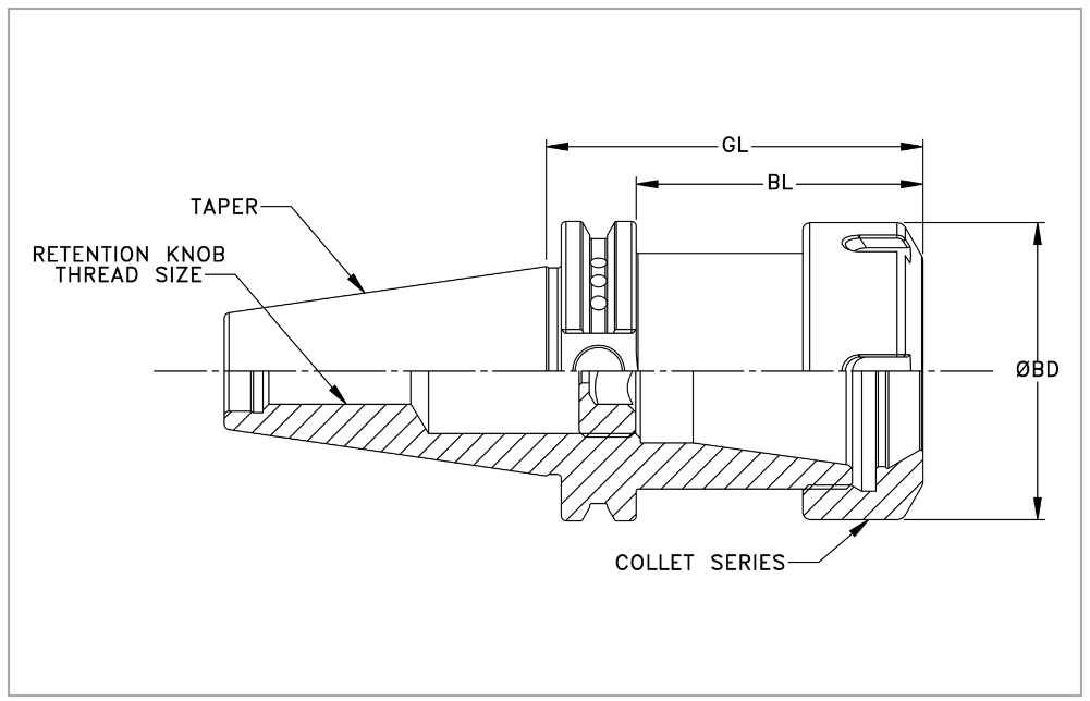

Taper SK40 \ DIN 69871
Collet Series ER-40
[ØBD] Body Diameter 63.0 mm
[GL] Gage Length 80.0 mm
[BL] Body Length 60.9 mm
Concentricity 0.003 mm
Balanced to RPM 25000
Retention Knob Thread Size M16X2.0
Through Tool Coolant Yes
Spindle Drive Slots Yes
Weight 2.9 lbs \ 1.3 kg
