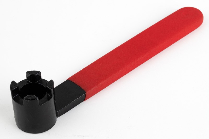

This HSK63A shell mill holder has a 27mm pilot bore and a 60mm gage length. It is constructed of hardened alloy steel, and designed to hold a variety of arbor-style shell mill and face mill cutters. The drive keys are removable for added versatility. Includes a solid arbor screw; a coolant-through arbor screw is required for through-tool coolant (TSC) cutters.
