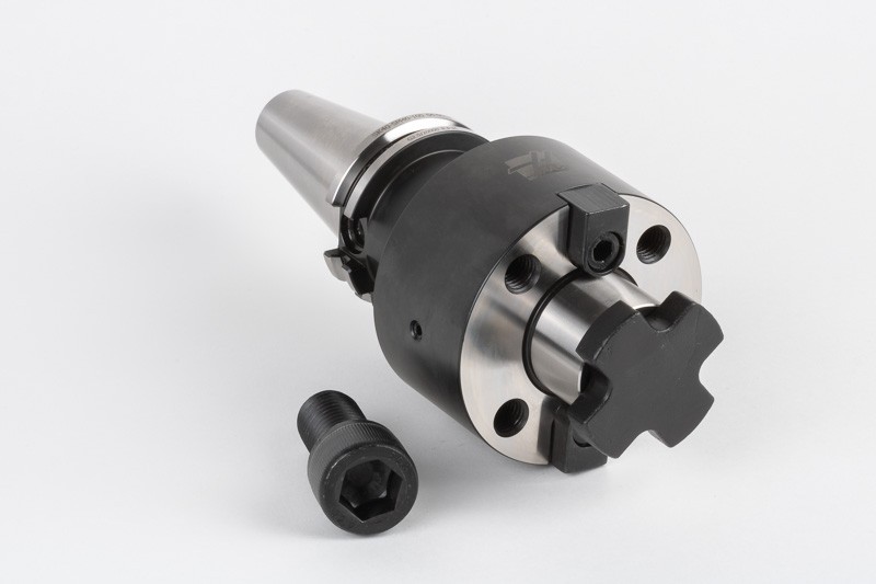

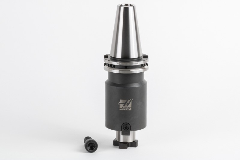

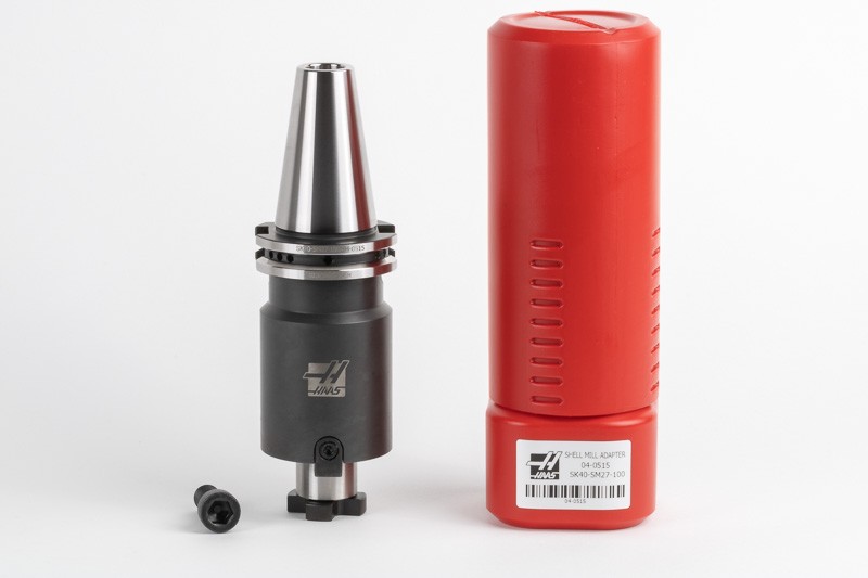

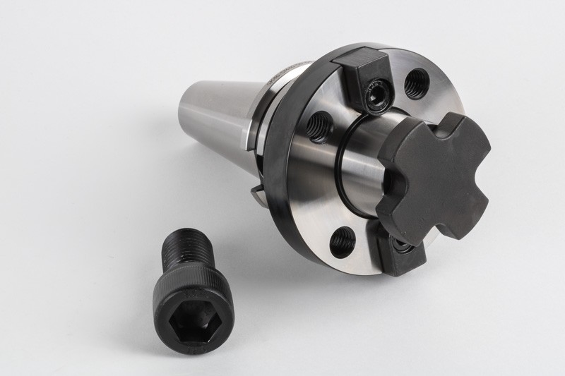

This SK40 \ DIN 69871 shell mill holder has a 27mm pilot bore and a 100mm gage length. It is constructed of hardened alloy steel, and designed to hold a variety of arbor-style shell mill and face mill cutters. The drive keys are removable for added versatility. Includes a solid arbor screw; a coolant-through arbor screw is required for through-tool coolant (TSC) cutters. This holder has a M16x2.0 pull stud/retention knob thread.

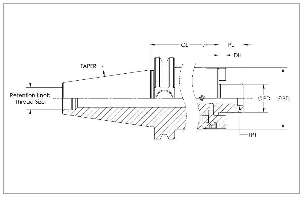

Taper SK40 \ DIN 69871
[ØPD] Pilot Diameter 27.0 mm
[ØBD] Body Diameter 78.0 mm
[GL] Gage Length 100.0 mm
[BL] Body Length 65.0 mm
[PL] Pilot Length 21.0 mm
[DH] Drive Lug Height 6.3 mm
[a] Keyway Width 12.0 mm
[TP1] Thread M12x1.75
Concentricity 0.01 mm
Balanced to RPM 20000
Retention Knob Thread Size M16X2.0
Through Tool Coolant Yes
Spindle Drive Slots Yes
Weight 5.7 lbs \ 2.6 kg
