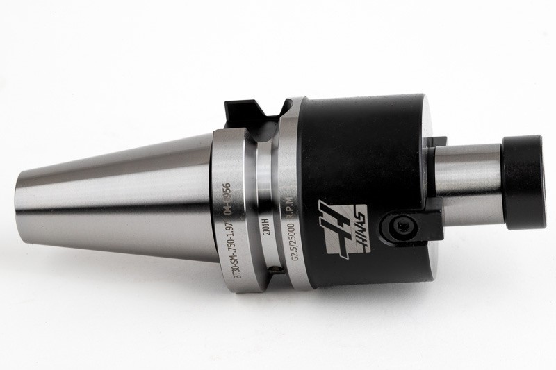

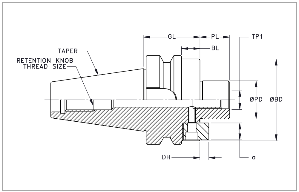

BT30 Shell Mill Holder, 3/4" Pilot Diameter x 50mm Gage Length, TSC
Part #: 04-0956
BT30-SM-.750-1.97"
Price: 80.95 ( / unit)
40.97

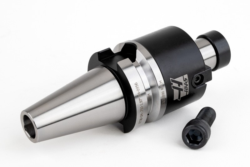

This BT30 shell mill holder has a 0.75 in \ 3/4" pilot bore and a 50mm gage length. It is constructed of hardened alloy steel, and designed to hold a variety of arbor-style shell mill and face mill cutters. The drive keys are removable for added versatility. Includes a solid arbor screw; a coolant-through arbor screw is required for through-tool coolant (TSC) cutters. This holder has a M12x1.75 pull stud/retention knob thread.
Taper BT30
[ØPD] Pilot Diameter 0.75 in \ 3/4"
[ØBD] Body Diameter 1.75 in
[GL] Gage Length 1.969 in
[BL] Body Length 1.104 in
[PL] Pilot Length 0.687 in
[DH] Drive Lug Height 0.159 in
[a] Keyway Width 0.313 in
[TP1] Thread 3/8"-24
Concentricity 0.0002 in
Balanced to RPM 25000
Retention Knob Thread Size M12X1.75
Through Tool Coolant Yes
Spindle Drive Slots Yes
Weight 1.2 lbs \ 0.6 kg
