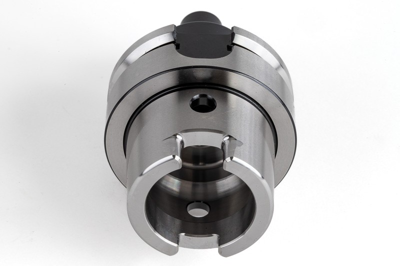

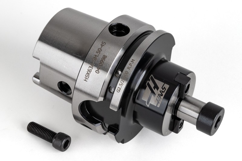

HSK63A Shell Mill Holder, 1/2" Pilot Diameter x 45mm Gage Length, TSC
Part #: 04-0998
HSK63A-SM.50-45
Price: 141.95 ( / unit)
78.97
This HSK63A shell mill holder has a 0.5 in \ 1/2" pilot bore and a 45mm gage length. It is constructed of hardened alloy steel, and designed to hold a variety of arbor-style shell mill and face mill cutters. The drive keys are removable for added versatility. Includes a solid arbor screw; a coolant-through arbor screw is required for through-tool coolant (TSC) cutters.

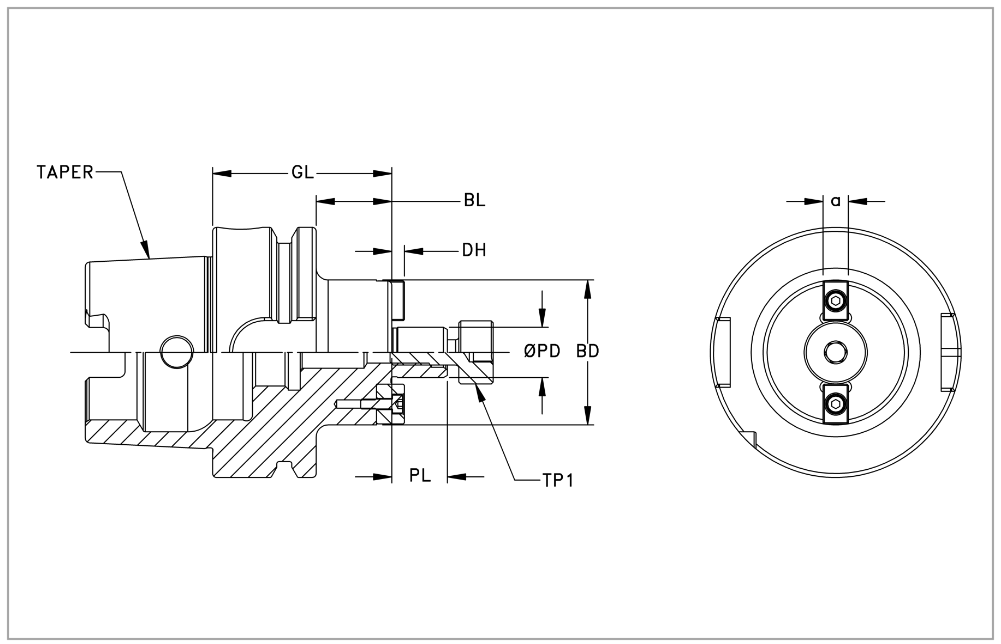

Taper HSK63A
[ØPD] Pilot Diameter 0.5 in \ 1/2"
[ØBD] Body Diameter 1.437 in
[GL] Gage Length 1.772 in
[BL] Body Length 0.748 in
[PL] Pilot Length 0.55 in
[DH] Drive Lug Height 0.125 in
[a] Keyway Width 0.25 in
[TP1] Thread 1/4"-28
Concentricity 0.0002 in
Balanced to RPM 20000
Through Tool Coolant Yes
Spindle Drive Slots Yes
Weight 2.4 lbs \ 1.1 kg
