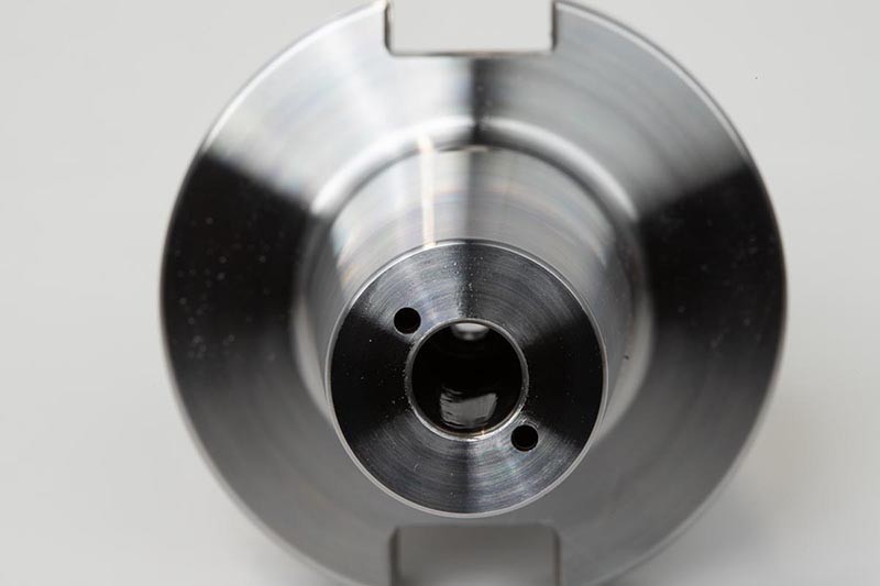

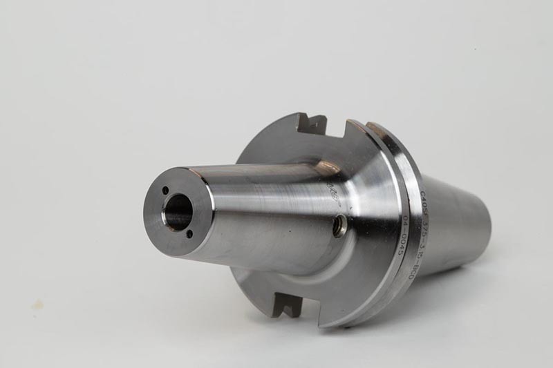

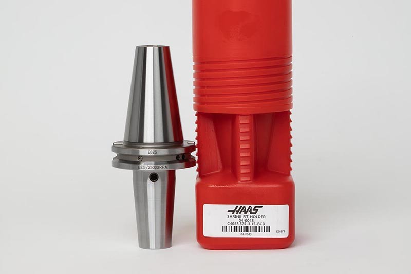

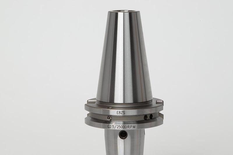

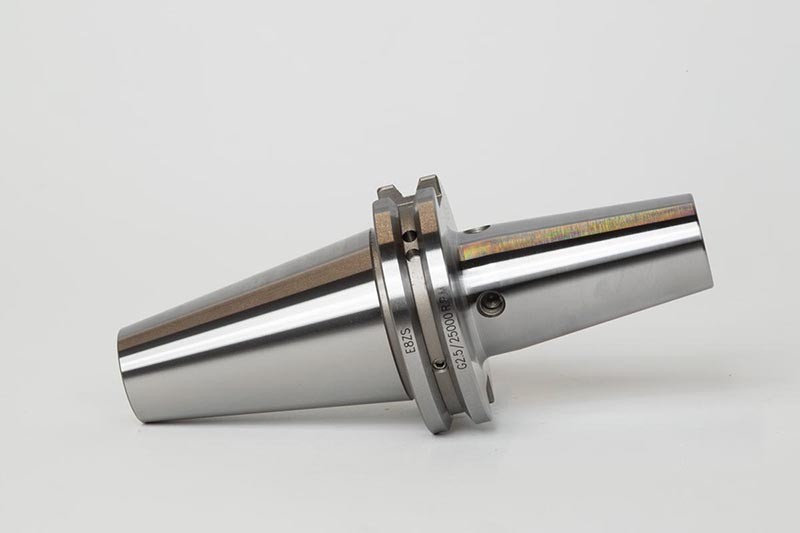

This CAT40 shrink fit holder has a 0.375 in \ 3/8" bore diameter, and a 3.15" gage length. It offers very low runout (0.0001" TIR), very high grip force, and quick tool changeovers when used in conjuction with Haas shrink fit machines. It is through-tool coolant (TSC) capable, with a 5/8"-11 pull stud/retention knob thread.

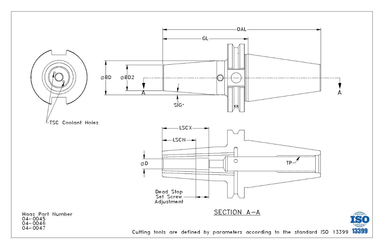

Taper CT40
[ØD] Bore Diameter 0.375 in \ 3/8"
[ØBD2] Minimum Body Diameter 0.945 in
[ØBD] Maximum Body Diameter 1.26 in
[GL] Gage Length 3.15 in
[OAL] Overall Length 5.837 in
[LSCN] Minimum Clamping Length 1.24 in
[LSCX] Maximum Clamping Length 1.713 in
[SIG°] Angle 4.5 °
Concentricity 0.00012 in
Balanced to RPM 25000
Retention Knob Thread Size 5/8"-11
Through Tool Coolant Yes
Spindle Drive Slots Yes
Weight 2.4 lbs \ 1.1 kg
