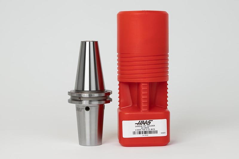

CT40 3/4" Shrink Fit Holder x 3.15" Gage Length, TSC
Part #: 04-0048
C40SF.750-3.15-BCD
Price: 157.95 ( / unit)
110.97

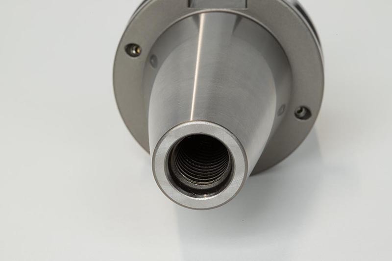

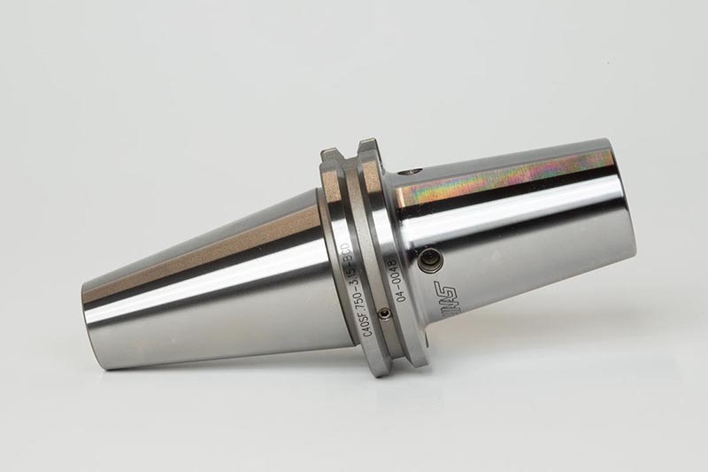

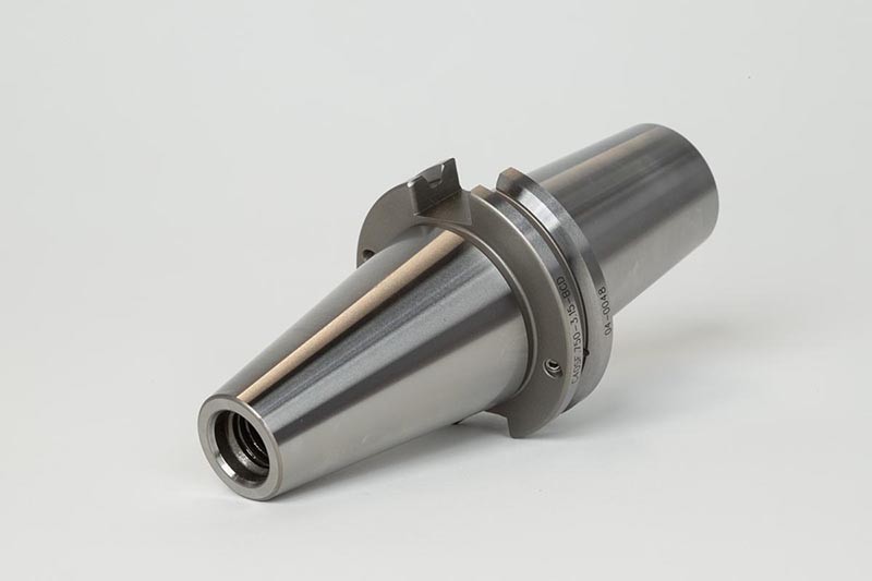

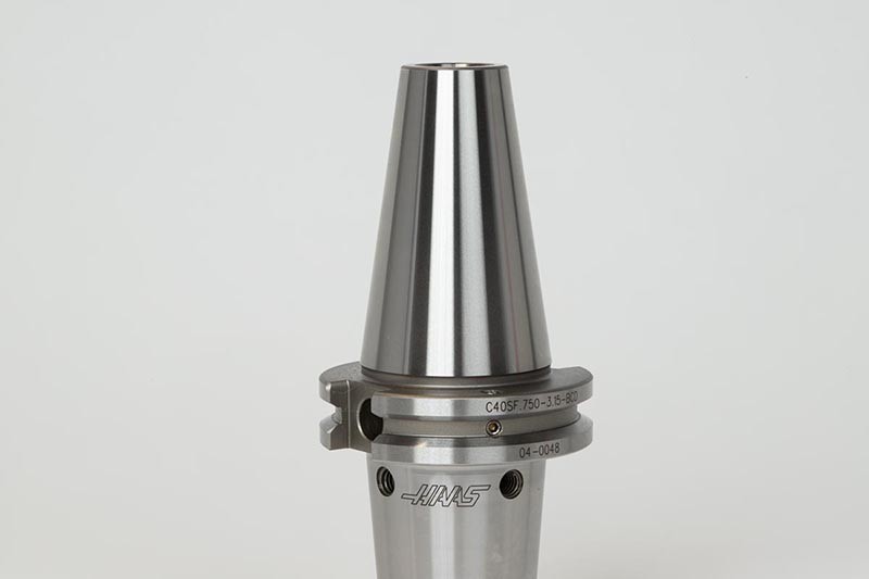

This CAT40 shrink fit holder has a 0.75 in \ 3/4" bore diameter, and a 3.15" gage length. It offers very low runout (0.0001" TIR), very high grip force, and quick tool changeovers when used in conjuction with Haas shrink fit machines. It is through-tool coolant (TSC) capable, with a 5/8"-11 pull stud/retention knob thread.

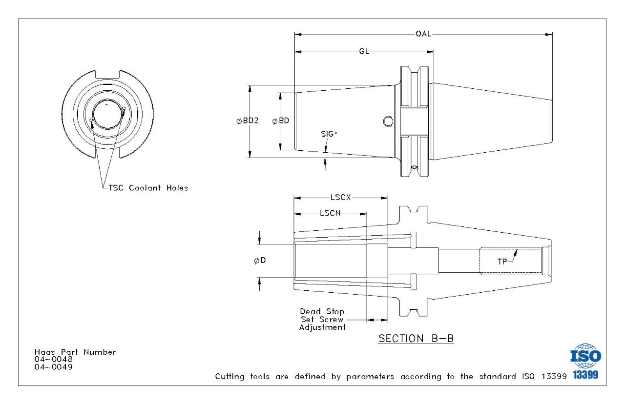

Taper CT40
[ØD] Bore Diameter 0.75 in \ 3/4"
[ØBD2] Minimum Body Diameter 1.299 in
[ØBD] Maximum Body Diameter 1.654 in
[GL] Gage Length 3.15 in
[OAL] Overall Length 5.837 in
[LSCN] Minimum Clamping Length 1.654 in
[LSCX] Maximum Clamping Length 2.126 in
[SIG°] Angle 4.5 °
Concentricity 0.00012 in
Balanced to RPM 25000
Retention Knob Thread Size 5/8"-11
Through Tool Coolant Yes
Spindle Drive Slots Yes
Weight 2.8 lbs \ 1.3 kg
