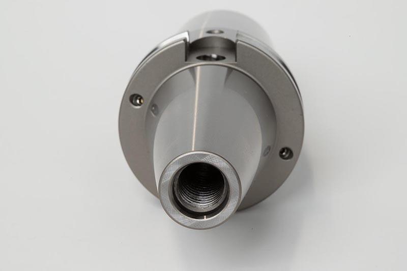

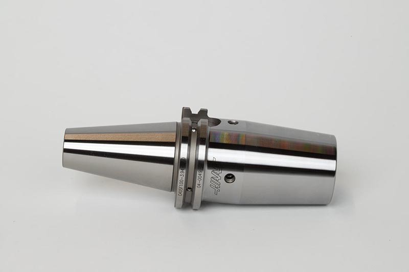

This CAT40 shrink fit holder has a 1.0 in \ 1" bore diameter, and a 3.937" gage length. It offers very low runout (0.0001" TIR), very high grip force, and quick tool changeovers when used in conjuction with Haas shrink fit machines. It is through-tool coolant (TSC) capable, with a 5/8"-11 pull stud/retention knob thread.
Taper CT40
[ØD] Bore Diameter 1.0 in \ 1"
[ØBD2] Minimum Body Diameter 1.732 in
[ØBD] Maximum Body Diameter 2.087 in
[GL] Gage Length 3.937 in
[OAL] Overall Length 6.624 in
[LSCN] Minimum Clamping Length 1.89 in
[LSCX] Maximum Clamping Length 2.362 in
[SIG°] Angle 4.5 °
Concentricity 0.00012 in
Balanced to RPM 25000
Retention Knob Thread Size 5/8"-11
Through Tool Coolant Yes
Spindle Drive Slots Yes
Weight 3.9 lbs \ 1.8 kg
