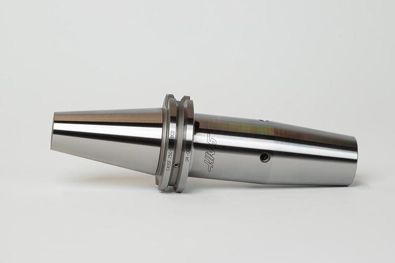

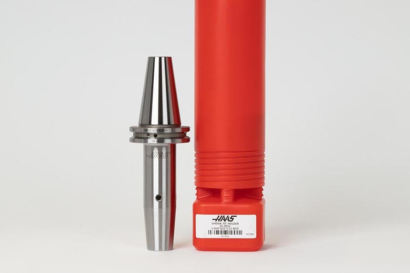

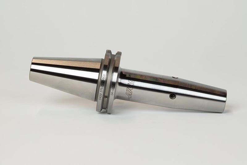

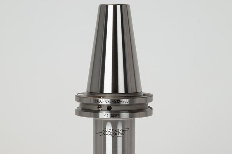

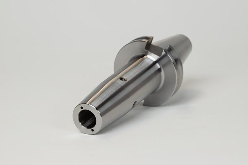

CT40 5/8" Shrink Fit Holder x 5.12" Gage Length, TSC
Part #: 04-0052
C40SF.625-5.12-BCD
Price: 178.95 ( / unit)
116.97
This CAT40 shrink fit holder has a 0.625 in \ 5/8" bore diameter, and a 5.118" gage length. It offers very low runout (0.0001" TIR), very high grip force, and quick tool changeovers when used in conjuction with Haas shrink fit machines. It is through-tool coolant (TSC) capable, with a 5/8"-11 pull stud/retention knob thread.
Taper CT40

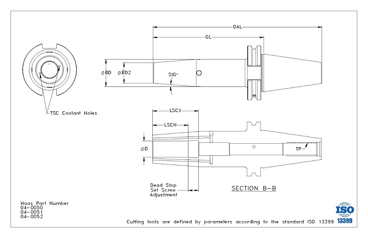

[ØD] Bore Diameter 0.625 in \ 5/8"
[ØBD2] Minimum Body Diameter 1.063 in
[ØBD] Maximum Body Diameter 1.339 in
[GL] Gage Length 5.118 in
[OAL] Overall Length 7.805 in
[LSCN] Minimum Clamping Length 1.575 in
[LSCX] Maximum Clamping Length 2.047 in
[SIG°] Angle 4.5 °
Concentricity 0.00012 in
Balanced to RPM 25000
Retention Knob Thread Size 5/8"-11
Through Tool Coolant Yes
Spindle Drive Slots Yes
Weight 3.2 lbs \ 1.4 kg
