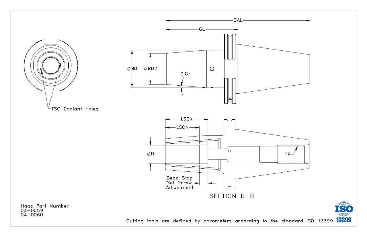

This CAT50 shrink fit holder has a 1.25 in \ 1-1/4" bore diameter, and a 4" gage length. It offers very low runout (0.0001" TIR), very high grip force, and quick tool changeovers when used in conjuction with Haas shrink fit machines. It is through-tool coolant (TSC) capable, with a 1"-8 pull stud/retention knob thread.
Taper CT50
[ØD] Bore Diameter 1.25 in \ 1-1/4"
[ØBD2] Minimum Body Diameter 1.732 in
[ØBD] Maximum Body Diameter 2.087 in
[GL] Gage Length 4.0 in
[OAL] Overall Length 8.0 in
[LSCN] Minimum Clamping Length 1.89 in
[LSCX] Maximum Clamping Length 2.362 in
[SIG°] Angle 4.5 °
Concentricity 0.00012 in
Balanced to RPM 25,000
Retention Knob Thread Size 1"-8
Through Tool Coolant Yes
Spindle Drive Slots Yes
Weight 7.7 lbs \ 3.5 kg
