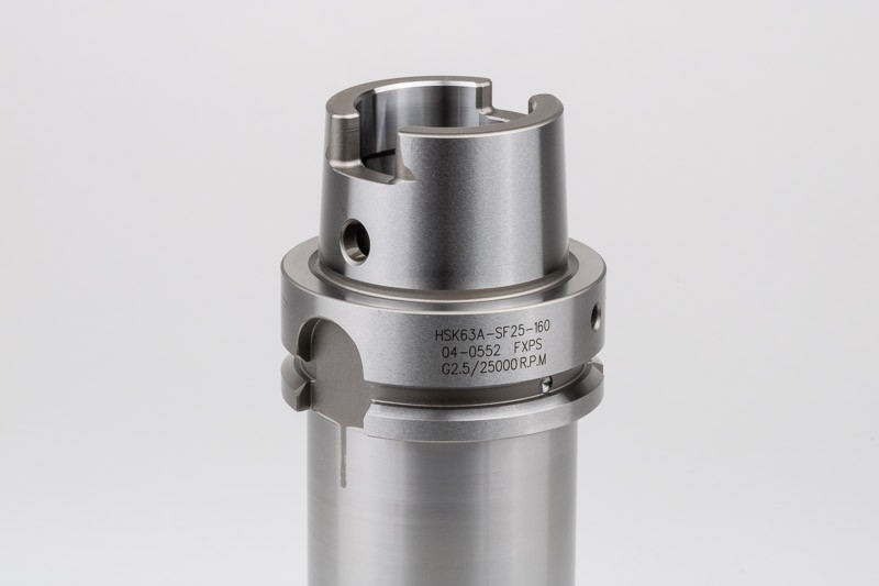

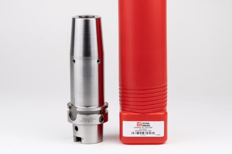

This HSK63A shrink fit holder has a 25mm bore diameter, and a 160mm gage length. It offers very low runout (0.003mm TIR), very high grip force, and quick tool changeovers when used in conjuction with Haas shrink fit machines. It is through-tool coolant (TSC) capable.
Taper HSK63A
[ØD] Bore Diameter 25.0 mm
[ØBD2] Minimum Body Diameter 44.0 mm
[ØBD] Maximum Body Diameter 53.0 mm
[GL] Gage Length 160.0 mm
[BL] Body Length 134.0 mm
[OAL] Overall Length 192.0 mm
[LSCN] Minimum Clamping Length 47.0 mm
[LSCX] Maximum Clamping Length 59.0 mm
[SIG°] Angle 4.5 °
Concentricity 0.003 mm
Balanced to RPM 25000
Through Tool Coolant Yes
Spindle Drive Slots Yes
Weight 4.0 lbs \ 1.8 kg
