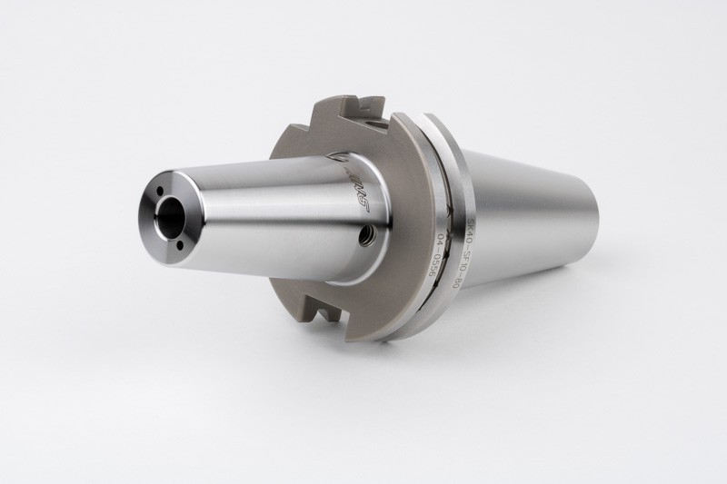

This SK40 \ DIN 69871 shrink fit holder has a 10mm bore diameter, and a 80mm gage length. It offers very low runout (0.003mm TIR), very high grip force, and quick tool changeovers when used in conjuction with Haas shrink fit machines. It is through-tool coolant (TSC) capable, with a M16x2.0 pull stud/retention knob thread.
Taper SK40 \ DIN 69871
[ØD] Bore Diameter 10.0 mm
[ØBD2] Minimum Body Diameter 24.0 mm
[ØBD] Maximum Body Diameter 32.0 mm
[GL] Gage Length 80.0 mm
[OAL] Overall Length 148.4 mm
[LSCN] Minimum Clamping Length 30.5 mm
[LSCX] Maximum Clamping Length 42.5 mm
[SIG°] Angle 4.5 °
Concentricity 0.003 mm
Balanced to RPM 25000
Retention Knob Thread Size M16X2.0
Through Tool Coolant Yes
Spindle Drive Slots Yes
Weight 2.4 lbs \ 1.1 kg
