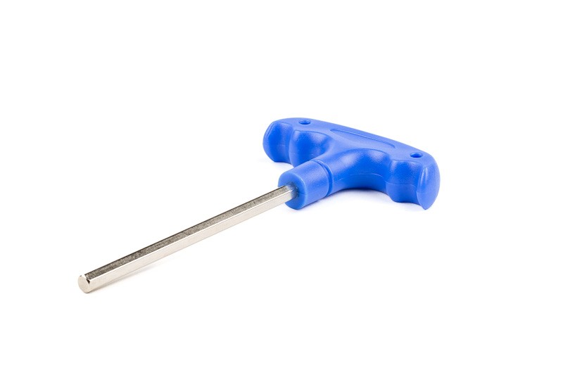

6mm T-handle for GT Vise
Part #: 06-0455
RETAIL PRICE:

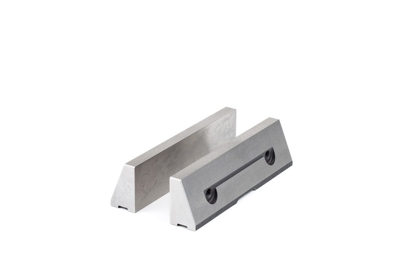

Hard Steel 150mm (6") Non-Machinable Modular Vise Jaws
Part #: 05-0274
RETAIL PRICE:
