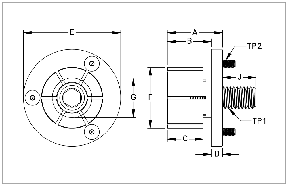

Size #6 ID Xpansion Clamp, 1.15" to 2.03" Machinable Range, Haas Workholding by Mitee-Bite
Part #: 05-0751
ID XPANSION CLAMP, SIZE#6, 5/8-11
Price: 101.95 ( / unit)
91.97
  • Technical Documents
Clamp Series ID Xpansion Clamp
Edge Type Machinable
Model Size #6
Material Soft Steel
[A] Dimension 1.56 in
[B] Dimension 1.25 in
[C] Dimension 1.06 in
[D] Dimension 0.31 in
[E] Dimension 2.972 in
[F] Machinable Stock 1.15 in - 2.03 in
[F] Dimension 2.03 in
[G] Dimension 1.15 in
[J] Dimension 0.79 in
[TP2] Thread #10-32
[TP1] Thread 5/8"-11
Maximum Spread 0.015 in
Maximum Torque 224 ft-lb
Holding Force 10000 lbs
Weight 1.7 lbs \ 0.8 kg
Country of Origin USA
05-0751
*G – Minimum diameter the “F” dimension can be machined or turned down to.
