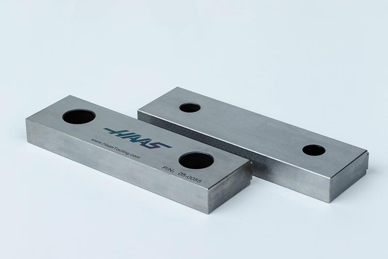

Hard Steel 6” (150mm) Non-Machinable Serrated Vise Jaws
Part #: 05-0055
HMVJ-61.8HS
Customer Rating:
Price: 120.95 ( / unit)
Price: 1823.95 ( / unit)
Price: 542.95 ( / unit)
Price: 72.95 ( / unit)
Price: 328.95 ( / unit)
Price: 765.95 ( / unit)
72.97
1299.97
386.97
51.97
233.97
545.97
HOW MUCH CLAMP FORCE IS TOO MUCH? THAT’S TOO MUCH  →
Avoid broken vise jaws like this one. Always be aware of the pressure or clamp force you are using on your part when working with automated vises, especially on narrow parts.
Dovetail Guidelines
Vise Type Manual
Vise Holding Type Fixed-Jaw
Vise Size 6" (150mm)
Jaw Style Serrated
Material Hard Steel
[ØD1] Counterbore Diameter 0.81 in \ 20.6 mm
[ØD2] Screw Hole Diameter 0.52 in \ 13.1 mm
[H] Height of Screw Hole 0.94 in \ 23.8 mm
[OAW] Overall Width 6.0 in \ 152.4 mm
[OAH] Overall Height 1.83 in \ 46.5 mm
[OAD] Overall Depth 0.71 in \ 18.0 mm
[S] Screw Spacing 3.88 in \ 98.4 mm
Rockwell Hardness HRC 46-50
Weight 4.15 lbs \ 1.88 kg

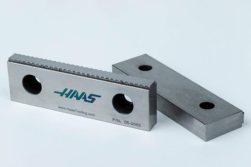

Hi, Is that fit 150mm Single-Station Fixed Jaw Vise, 225mm Opening, Flange Style, Haas Workholding by Kurt ???
1 Answers
Haas Tooling Support
Apr 29 2025
Yes, they are compatible with the 150mm Single-Station Fixed Jaw Vise 225mm Opening, Flange Style, Haas Workholding by Kurt part # 05-0213
May Richardson
Apr 07 2025
If I wanted to cut dovetails onto my stock to make full use of the geometry of these jaws, do you sell a dovetail milling tool that would be suitable for the shape of these jaws?
1 Answers
Apr 07 2025
These jaws require a 45-degree dovetail. We recommend using cutter part #03-1098 for prepping your stock.
Sam Smith
May 20 2023
Does stock have to be dovetailed prior to clamping or can thees be used like Mitee Bite talon grips and clamp on raw stock?
1 Answers
May 22 2023
These jaws can be used as simple serrated jaws that can grip stock that isn’t prepared with a dovetail. However, depending on what material you are machining and the aggressiveness of your machining plan, we strongly recommend machining dovetails on the material.
Thomas
May 10 2023
Are these sold as a pair?
1 Answers
May 10 2023
Yes, these vise jaws are sold as a pair.
Matt
Mar 29 2023
What is the recommended torque specs for tool steel?
3 Answers
Mar 29 2023
Thank you for your question. There is no torque spec for the bolts for these vise jaws. They just need to be snug enough to prevent the jaws from moving while parts are being machined. These jaws are secured with 1/2-13 bolts. If you are looking for a general reference, the recommended torque spec for a bolt this size is between 30 and 50 ft-lbs.
Matt
Apr 20 2023
I mean how much torque is recommended when clamping parts with these jaws not the bolts securing them to the vise?
Apr 21 2023
While there are too many variables involved to completely answer this question, generally speaking, for larger/thicker/heavier workpieces (i.e. steels) or a piece of raw stock, the vise is torqued until fully snug—somewhere around the high range of 50 to 80 ft-lb. For smaller/thinner/lighter workpieces (i.e. aluminum, or 2nd+ operation parts), it is recommended to use a lower range of torque, somewhere around 10 to 50 ft-lb. This is because thinner, or lighter parts, have a tendency to deflect and deform compared to their heavier counterparts; for these thinner/lighter parts, as long as the part does not move or shift in the vise, then generally, it is assumed that the applied torque is acceptable. Having said that, since these specific jaws are hardened steel, they are more susceptible to fracturing, so one should slowly sneak up on any torque values. These jaws are used in manual vises as well as electric vises, so the application and outcome can vary. We hope we’ve been able to sufficiently answer your question. If there is anything else that you need, please feel free to reach out to us.
