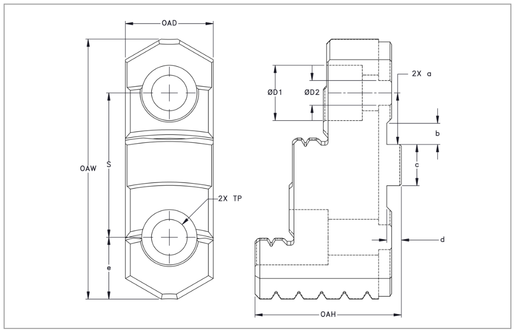

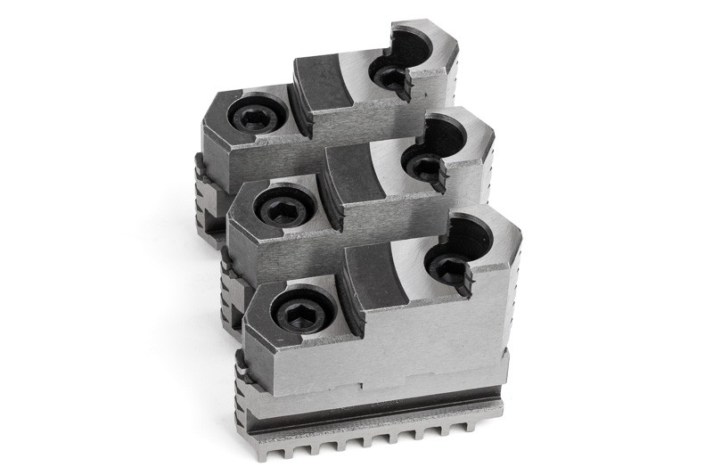

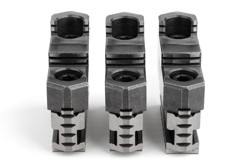

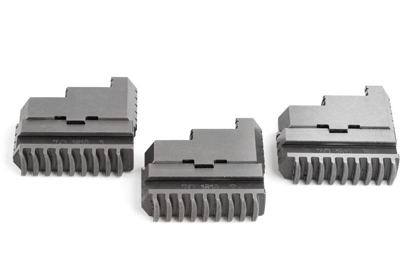

Hard Steel Non-Machinable Chuck Jaws - Haas 8" (200mm) 3-Jaw Mill Chuck
Part #: 05-0257
JAWS FOR 8" 3-JAW CHUCK, HARD
Price: 136.95 ( / unit)
Vise Type Manual
Vise Holding Type 3-Jaw Chuck
Material Hard Steel
[ØD1] Counterbore Diameter 0.669 in \ 17.0 mm
[ØD2] Screw Hole Diameter 0.433 in \ 11.0 mm
[a] Dimension 0.624 in \ 15.86 mm
[b] Dimension 0.256 in \ 6.5 mm
[c] Dimension 0.499 in \ 12.68 mm
[d] Dimension 0.177 in \ 4.5 mm
[e] Dimension 0.75 in \ 19.04 mm
[OAW] Overall Width 3.15 in \ 80.0 mm
[OAH] Overall Height 1.772 in \ 45.0 mm
[OAD] Overall Depth 1.063 in \ 27.0 mm
[S] Screw Spacing 1.748 in \ 44.4 mm
[TP] Thread Pitch M10x1.5
Weight 0.8 lbs \ 0.4 kg
