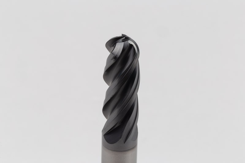

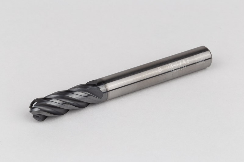

This HTPM 4-flute carbide ball end mill has a 8mm cutting diameter, with a 8mm smooth shank, 22mm length of cut (LOC), 4mm ball radius, and a 70mm overall length. It is hybrid AlCrN coated, and made to cut steel, stainless steel, and cast iron, but is capable of cutting some grades of high temp. alloys.
ISO MATERIAL CHART
Haas Milling Series HTPM
Primary Workpiece Material P - Steel, M - Stainless Steel, K - Cast Iron
Material Carbide
Coating Hybrid AlCrN
Corner Type Ball
Shank Type Smooth
[ØDC] Cutting Diameter 8.0 mm
[ØDMM] Shank Diameter 8.0 mm
[LOC] Length Of Cut 22.0 mm
[OAL] Overall Length 70.0 mm
[NOF] Number of Flutes 4
[R1] Radius 4.0 mm
[FHA°] Helix Angle 35/37
Cutting Direction Right
Center Cutting Yes
Variable Pitch Yes
Through Spindle Coolant No
Weight 0.2 lbs \ 0.1 kg
