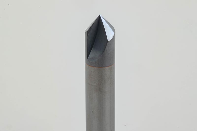

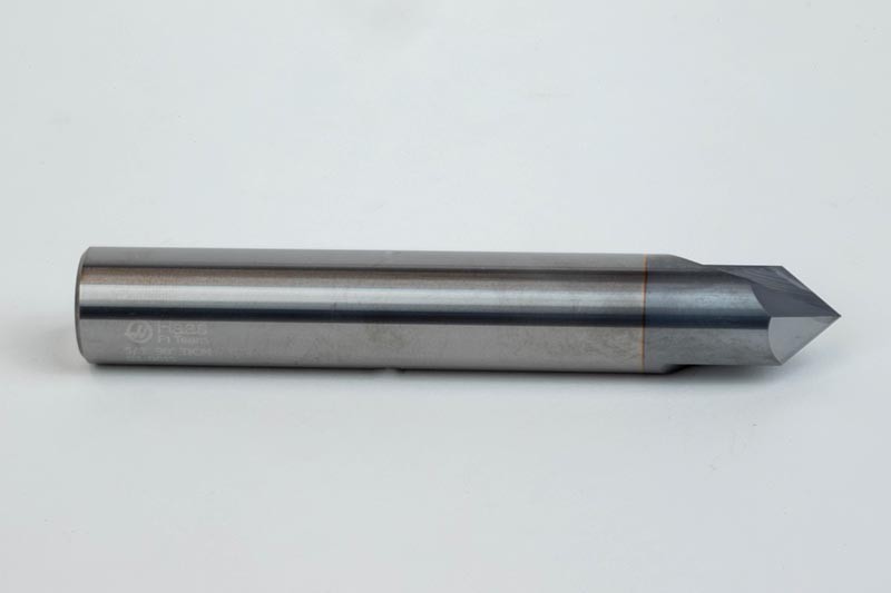

5/8" Dia. 45° Carbide Chamfer Mill, 2 Flute, TiCN Coated, 5/16" LOC x 4" Overall Length, HSAM1
Part #: 03-0615
CHAMFER END MILL 5/8" 45 DEG 2FL TICN
Price: 82.95 ( / unit)
66.97
This HSAM1 45-degree 2-flute carbide chamfer end mill has a 0.625 in \ 5/8" smooth shank, with a 5/16" length of cut (LOC), 0.043" web thickness, and a 4" overall length. It is TiCN coated, and made to cut steel and aluminum/non-ferrous materials, but is capable of cutting some grades of stainless steel and cast iron.
ISO Material Chart
Haas Milling Series HSAM1
Primary Workpiece Material N - Aluminum, P - Steel
Secondary Workpiece Material M - Stainless Steel, K - Cast Iron
Material HSS, Brazed Carbide Tip
Coating TiCN
Corner Type Chamfer
Shank Type Smooth
[ØDMM] Shank Diameter 0.625 in \ 5/8"
[W] Web 0.043 in
[LOC] Length Of Cut 0.313 in
[OAL] Overall Length 4.0 in
[NOF] Number of Flutes 2
[SIG°] Chamfer Angle 45 Degree
Weight 0.6 lbs \ 0.3 kg
Country of Origin USA
