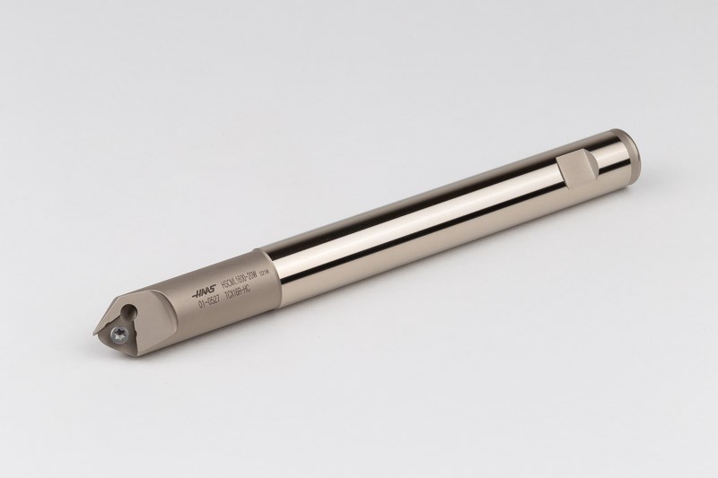

This 45-degree indexable chamfer mill has a 0.2mm minimum cutting diameter and a maximum cutting diameter of 21.2mm. It has a 20mm shank diameter and an overall length of 200mm. It takes 1 triangle chamfer insert (TCX16R), which is available in grades for steel, stainless steel, cast iron, aluminum/non-ferrous materials, and hardened metals.
Tool Or Insert Tool
[ØDC] Cutting Diameter 0.2 mm
[ØDCX] Max Cutting Diameter 21.2 mm
[ØDMM] Shank Diameter 20.0 mm
[OAL] Overall Length 200.0 mm
[LH] Head Length 60.0 mm
[Ap] Max. Cutting Depth 10.0 mm
[SIG°] Chamfer Angle 45 Degree
[NOF] Number of Flutes 1
Insert Size TCX16R
Weight 1.1 lbs \ 0.5 kg
