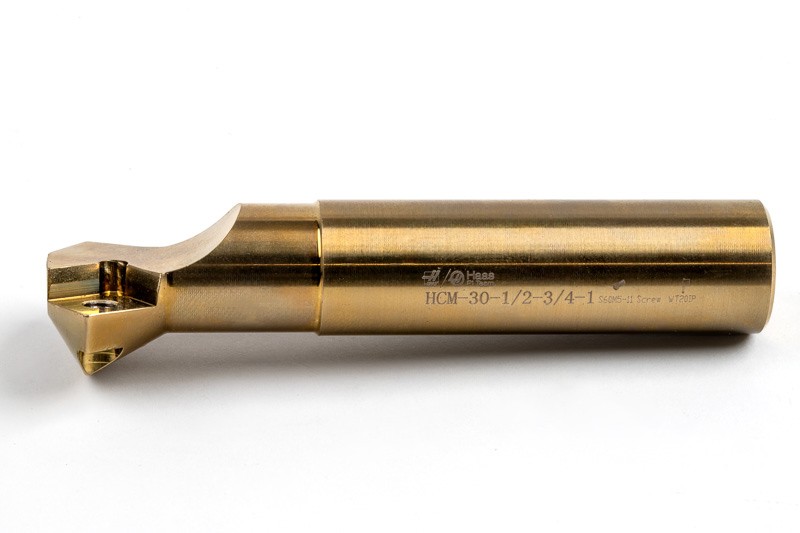

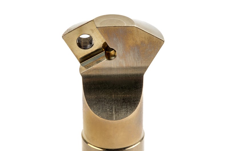

60° Indexable Chamfer Mill, 0.5 in \ 1/2" - 1.137" Diameter x 3/4" Shank x 4" Overall Length, 1 Insert
Part #: 01-0761
HCM-60-1/2-3/4-1
Price: $66.95 ( / unit)
$56.97
This 60-degree indexable chamfer mill has a 0.5 in \ 1/2" minimum cutting diameter and a maximum cutting diameter of 1.137". It has a 3/4" shank diameter and an overall length of 4". It takes 1 square chamfer insert (SPㅁㅁ1204ㅁㅁ), which is available in grades for steel, stainless steel, cast iron, and aluminum/non-ferrous materials.

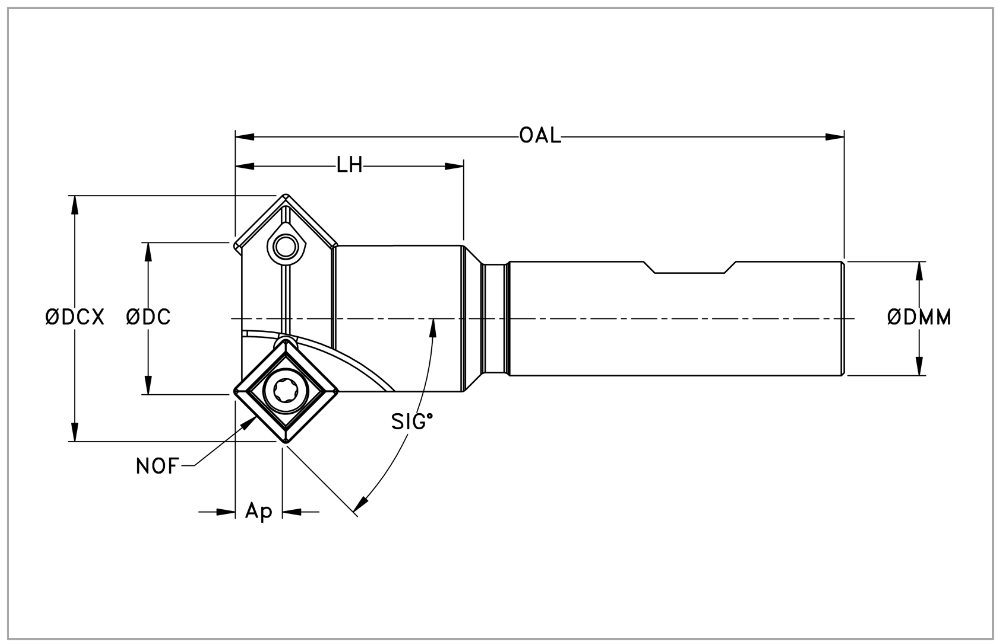

Tool Or Insert Tool
[ØDC] Cutting Diameter 0.5 in
[ØDCX] Max Cutting Diameter 1.137 in
[ØDMM] Shank Diameter 0.75 in
[OAL] Overall Length 4.0 in
[LH] Head Length 1.5 in
[Ap] Max. Cutting Depth 0.216 in
[SIG°] Chamfer Angle 60 Degree
[NOF] Number of Flutes 1
Insert Size SPㅁㅁ1204ㅁㅁ
Weight 0.4 lbs \ 0.2 kg
