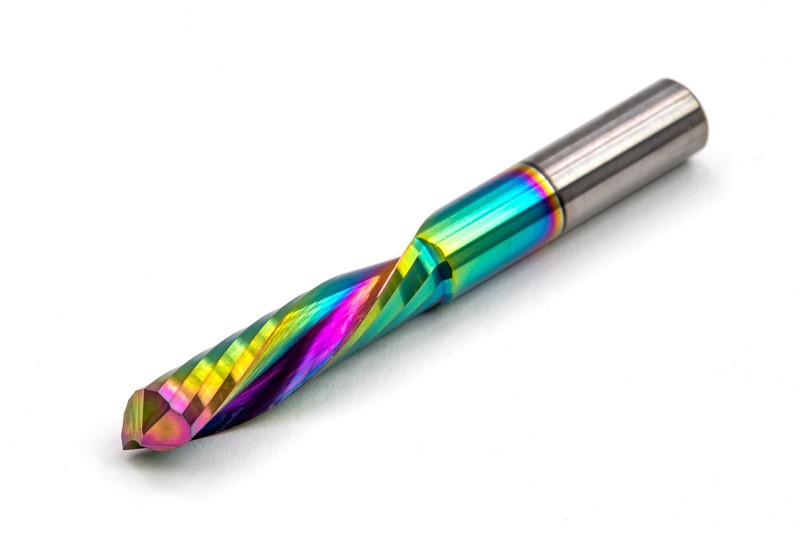

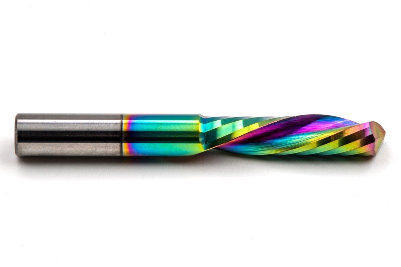

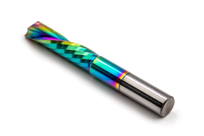

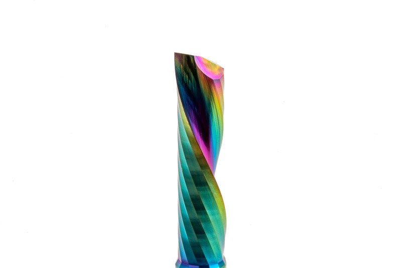

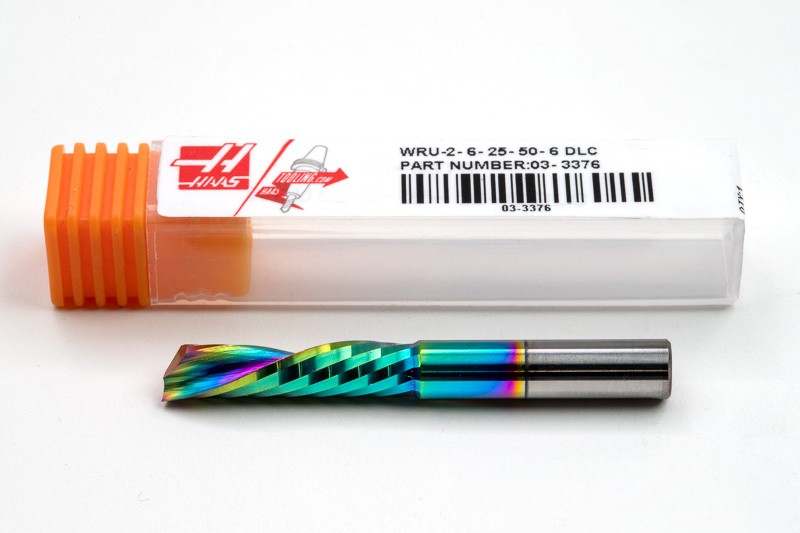

6mm Dia. Carbide Down Cut End Mill CNC Router Bit, 1 Flute, DLC Coated, 6mm Smooth Shank x 25mm LOC
Part #: 03-3376
WRU-2-6-25-50-6 DLC
Price: 16.95 ( / unit)
This 1-flute carbide down cut end mill has a 6mm smooth shank, 25mm length of cut (LOC), and a 50mm overall length. It is DLC coated, and made to cut all types of woods. This end mill is designed to down cut .
Type End Mill
Cut Type Down Cut
Toolpath Type Slotting, Shoulder Milling, Face Milling
[ØDC] Cutting Diameter 6.0 mm
[LOC] Length Of Cut 25.0 mm
Material Carbide
Coating DLC
[NOF] Number of Flutes 1
Shank Type Smooth
[ØDMM] Shank Diameter 6.0 mm
[OAL] Overall Length 50.0 mm
Cutting Direction Right
Weight 0.1 lbs / 0.1 kg
