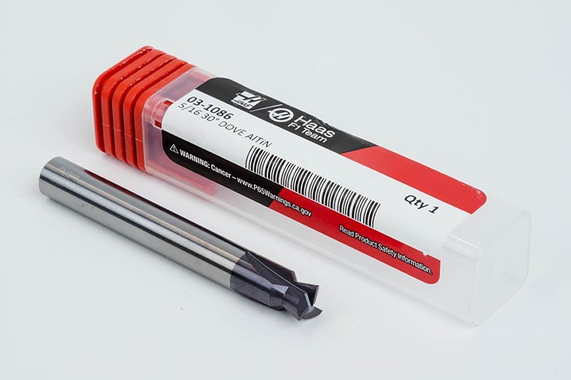

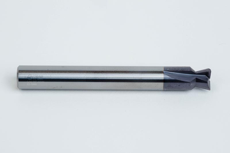

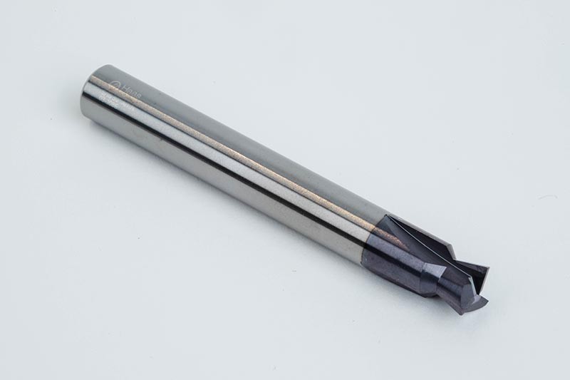

5/16" Dia. Carbide Dovetail Cutter, 3 Flute, AlTiN Coated, 5/16" Shank x 0.187" LOC x 30° Included Angle, 0.01" Radius
Part #: 03-1086
DOVETAIL CUTTER CARBIDE 5/16" 30 DEG
Price: 76.95 ( / unit)
42.97
This 30-degree 3-flute carbide dovetail cutter has a 0.3125 in \ 5/16" cutting diameter, with a 5/16" smooth shank, 0.187" length of cut (LOC), 0.01" corner radius, and a 2-1/2" overall length. It is AlTiN coated, and made to cut steel, stainless steel, cast iron, high temp. alloys, and hardened metals.
