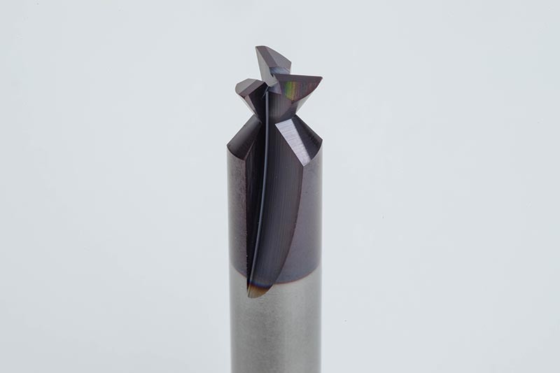

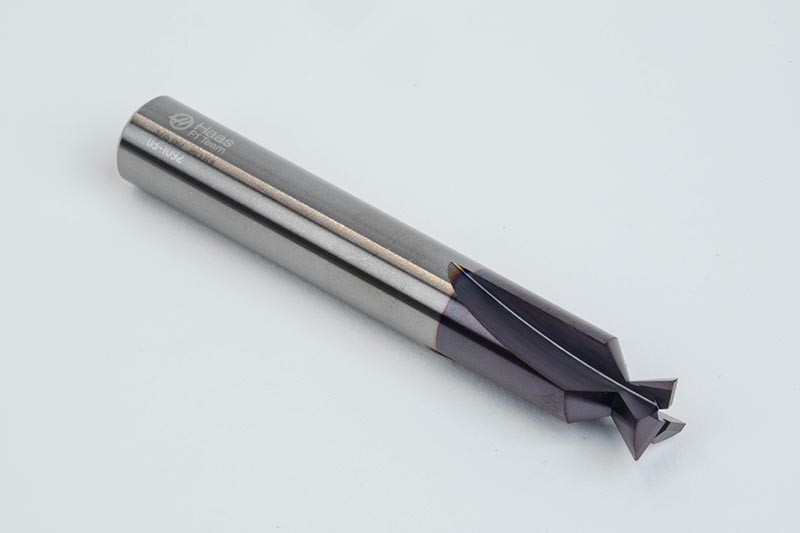

3/8" Dia. Carbide Dovetail Cutter, 3 Flute, AlTiN Coated, 3/8" Shank x 0.187" LOC x 60° Included Angle, 0.01" Radius
Part #: 03-1092
DOVETAIL CUTTER CARBIDE 3/8" 60 DEG
Customer Rating:
Price: $79.95 ( / unit)
$43.97
This 60-degree 3-flute carbide dovetail cutter has a 0.375 in \ 3/8" cutting diameter, with a 3/8" smooth shank, 0.187" length of cut (LOC), 0.01" corner radius, and a 2-1/2" overall length. It is AlTiN coated, and made to cut steel, stainless steel, cast iron, high temp. alloys, and hardened metals.
$41.77 (Save 5%)
DOVETAIL CUTTERS OVERVIEW
____________________________
Dovetail cutters are specialized tools for cutting angled or trapezoidal-shaped grooves (dovetails) into a workpiece. They are used to cut the male and female parts of dovetail joints for industrial slides, as well as for cutting bevels and undercuts, and for deburring parts.
Dovetail cutters are also used to cut external features on workpieces for clamping in dovetail-style workholding. The dovetail creates a strong and secure area for clamping, while sacrificing minimal raw material, allowing more surface area of the part to be exposed to the cutting tool. This makes dovetails a great way to securely hold your workpiece during 5-axis operations.
APPLICATIONS:
  • Dovetail slots for industrial slides
  • External features for workholding
  • Detailed undercuts
  • Deburring
TIPS:
  • Rough slots with an end mill first
  • Calculate feedrates based on the smaller neck diameter
  • Calculate speeds based on the larger end diameter
  • Take shallow depths of cut
  • SPEEDS & FEEDS (INCH)
  • SPEEDS & FEEDS (METRIC)
ISO MATERIAL CHART
Primary Workpiece Material P - Steel, S - High Temp Alloys, K - Cast Iron, M - Stainless Steel, H - Hardened Steels
Material Carbide
Coating AlTiN
Shank Type Smooth
[ØDC] Cutting Diameter 0.375 in \ 3/8"
[ØDMM] Shank Diameter 0.375 in
[ØN] Neck Diameter 0.174 in
[LOC] Length Of Cut 0.187 in
[OAL] Overall Length 2.5 in
[NOF] Number of Flutes 3
[CHW\RE] Chamfer \ Radius Size 0.01 in
[SIG°] Included Angle 60
Cutting Direction Right
Country of Origin USA
