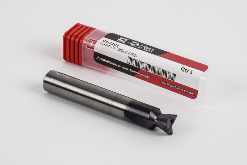

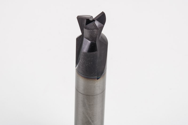

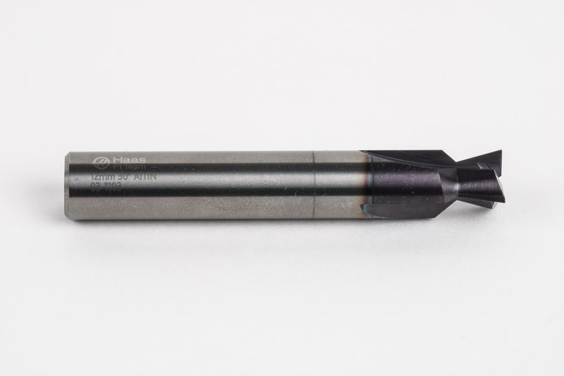

This 30-degree 3-flute carbide dovetail cutter has a 12mm cutting diameter, with a 12mm smooth shank, 7.92mm length of cut (LOC), 0.25mm corner radius, and a 76mm overall length. It is AlTiN coated, and made to cut steel, stainless steel, cast iron, high temp. alloys, and hardened metals.

[ØDC] Cutting Diameter 12.0 mm
[ØDMM] Shank Diameter 12.0 mm
[ØN] Neck Diameter 8.61 mm
[LOC] Length Of Cut 7.92 mm
[OAL] Overall Length 76.0 mm
[NOF] Number of Flutes 3
[CHW\RE] Chamfer \ Radius Size 0.25 mm
[SIG°] Included Angle 30
Cutting Direction Right
Weight 0.3 lbs \ 0.1 kg
Country of Origin USA
